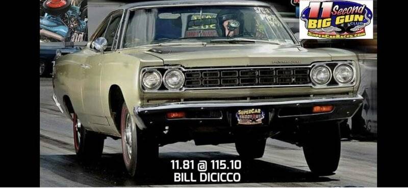

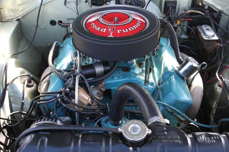

My 2 cents. 10:1 451. Factory manifolds intake and exhaust. Runs 11.81 @ 115 with more in it. Totally streetable. If you build to work with manifolds you can get most of what headers offer for a street car.

Very cool. For us onlookers, what have you done to get you there? Seems like the headers (if that’s what you happen to want) might get someone to the same place with “less engine” so to speak. That’s certainly fast for a car with manifolds.
But have you tried headers on the combo to compare
The engine was designed and built to work with the manifolds. While headers would make some improvement it’s not what it would be with an engine designed to take advantage of them.

The intake on that motor is a bigger hindrance than the exhaust.
Nice!
What is the race weight?
