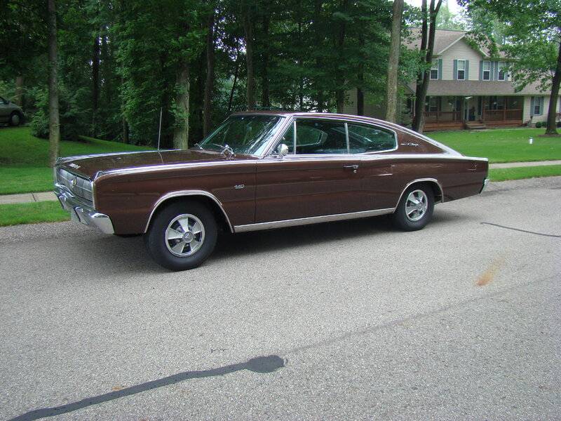

My 1967 Dodge Charger 1/4 mile ET is 12.87 at 109.26 mph with manifolds...
Stock tires with 3.23 suregrip.

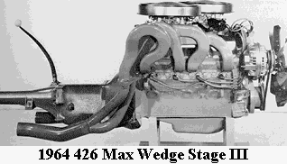

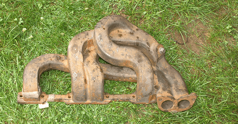

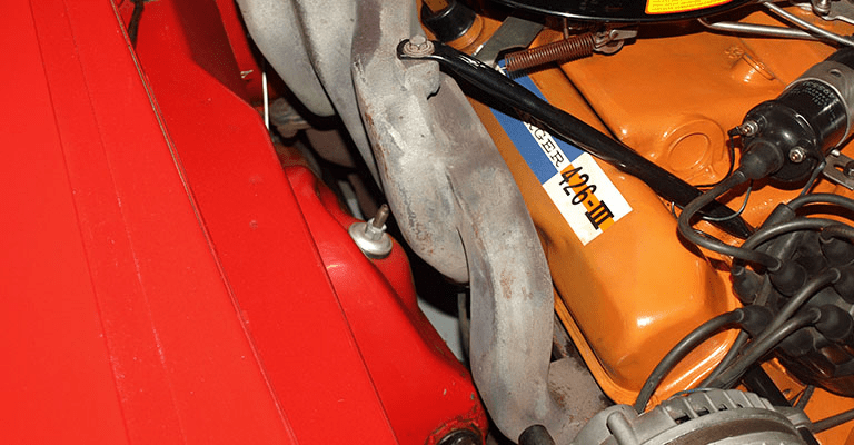

Continuing the header vs factory HP manifold controversy....one of the absolute best set of factory HP manifolds I've ever sern was on the Max Wedge cars... 4 into 2 into one EQUAL LENGTH CAST IRON MANIFOLDS with the removable caps on the manifold outlet pipes......extremely rare but extremely well designed and ABSOLUTELY and Totally cool looking. I've only witnessed 2 different cars with this option...a 1964 Plymouth Savoy and a Dodge 2 dr sedan.....sure beats anything currently offered....
I think that only 30-40 sets were ever profuced. They were relatively heavy @ ~ 40#, compared to tubular headers.....
