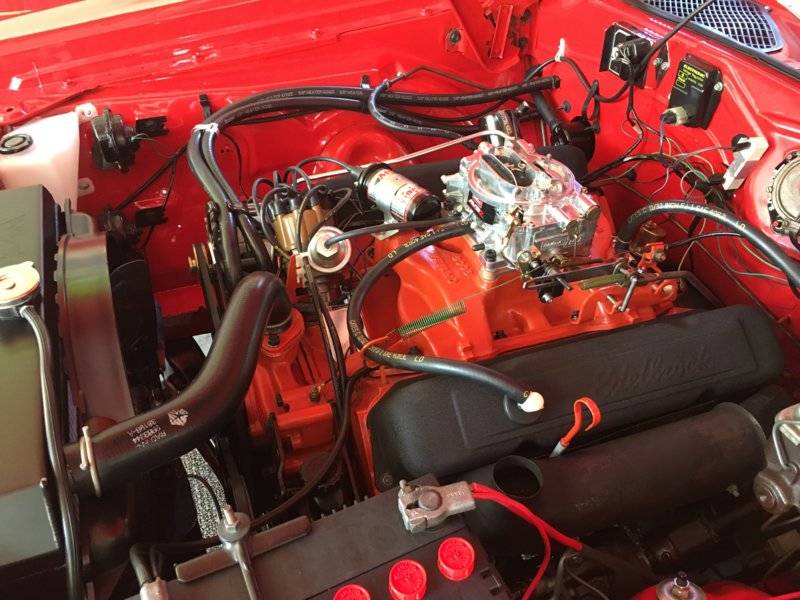

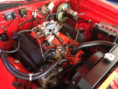

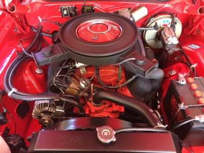

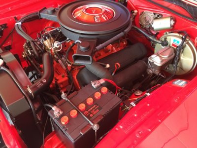

Built my motor back a few years ago
Numbers 383 / Now a 440 source 432 Stroker
E Street Heads 75cc
Comp Cams XE275 HL
Original Factory HP Manifolds
Edelbrock 800 AVS2
10.5 Compression - 200#s cold cranking compression on all eight cylinders
Street car with 3:91 Sure Grip / Auto Trans - Honestly great torque on the street , to much for the 275/60 15" Tires out of the hole off idle
RPM’s come on fast shifting the slap stick at 5400/5500
*(Really considering the TTI Shorty Headers for 383 / 400 and head pipes)*
However I don’t want to spend all that time and money for a 10/20 HP difference
‘Now a 50 HP difference and torque , YES I do
Motor or car has never been on a Dyno so what should I expect if I went from HP Manifolds to TTI Shorty Headers ?
Thanx Scott
