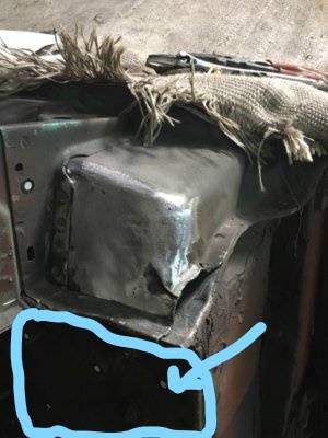

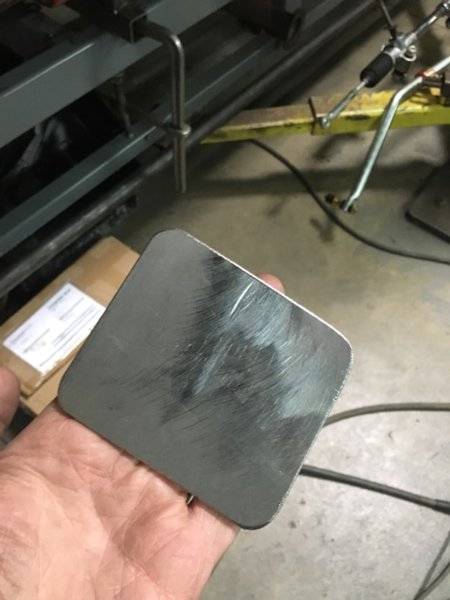

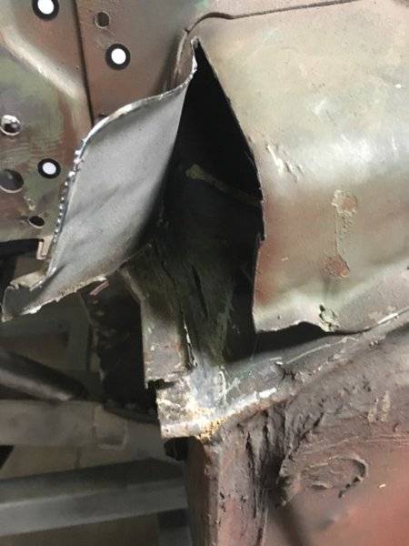

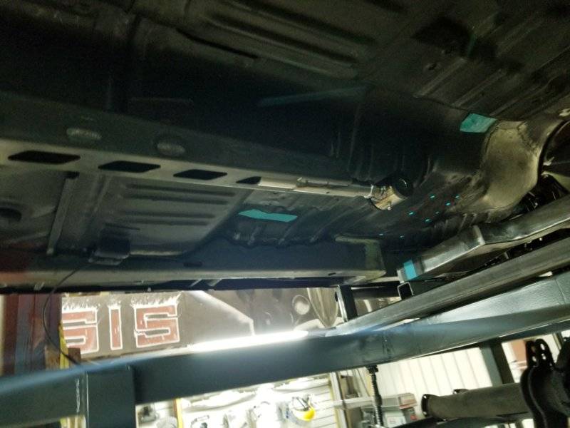

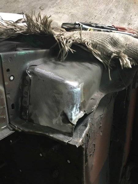

Both sides done tonight and you can see here the backing plate was put in for the upper tie in point of the strut bars.
IMG_0300.jpg IMG_0299.jpg IMG_0302.jpg IMG_0303.jpg IMG_0306.jpg 20180405_213832.jpg 20180405_213818.jpg

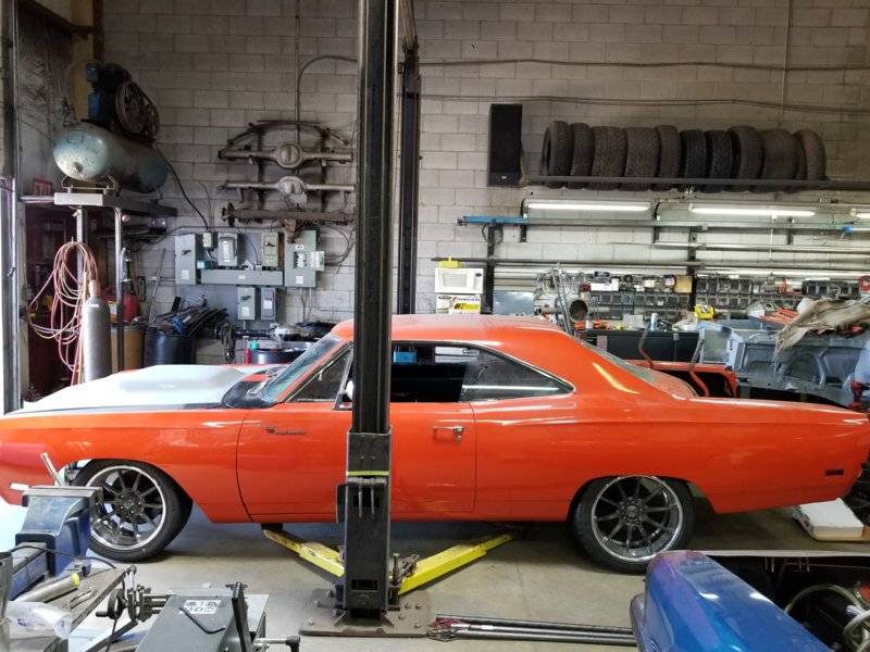

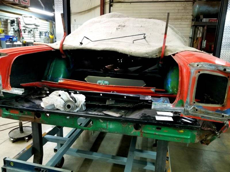

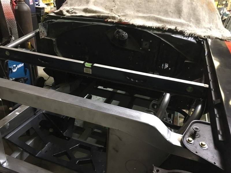

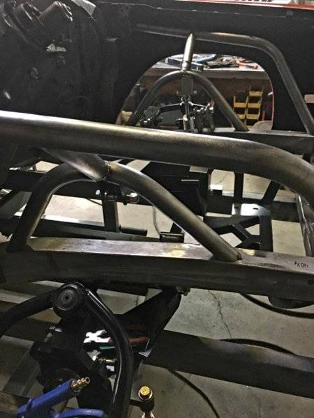

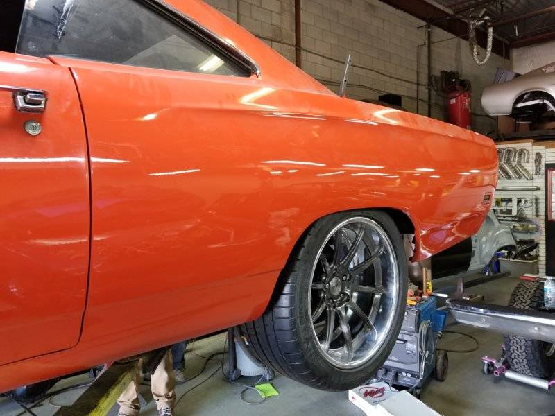

Trial fitting the front wheels now that the front brakes are on and move to the back replacing the tail panel and trunk floor and it looks like probably the whole passenger side quarter :(

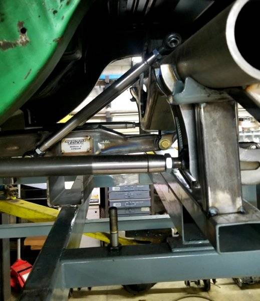

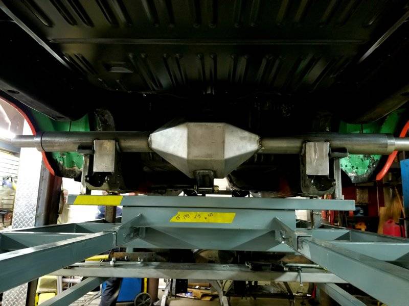

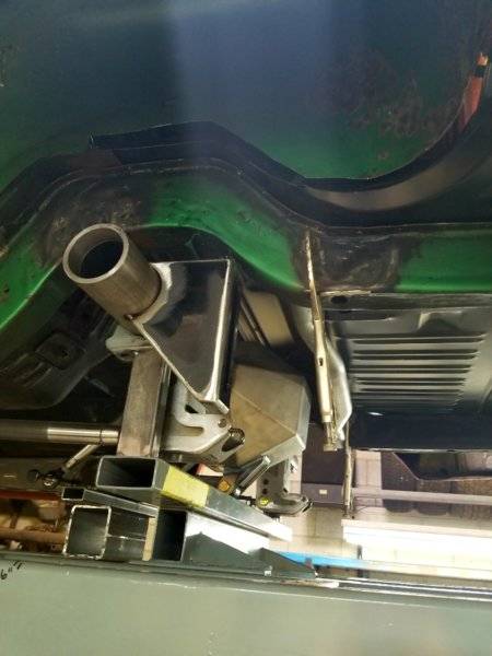

The same time getting things ready with the fab housing for the torque arm
20180412_102202.jpg 20180411_130936.jpg 20180411_130924.jpg 20180411_130845.jpg

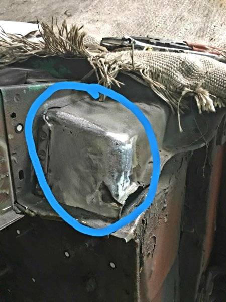

I see, so how did it get welded inside there? Welded to what? Was it there just to give a stronger spot to attach the bar?
It was welded in while the piece was opened up and then closed in. The front part you could see was drilled through so a bead could be run around the backing plate then brazed

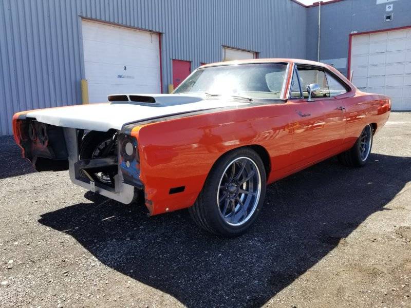

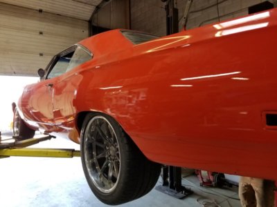

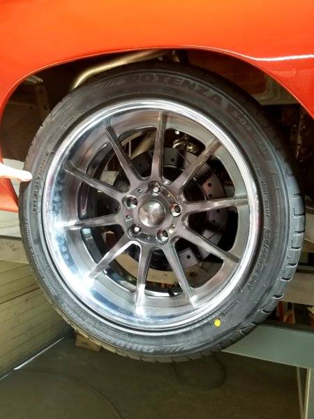

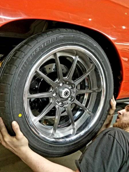

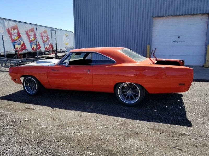

I did however still get to the shop to mount my rims again and make sure my new centre calls clear the spindles lol

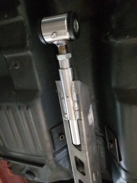

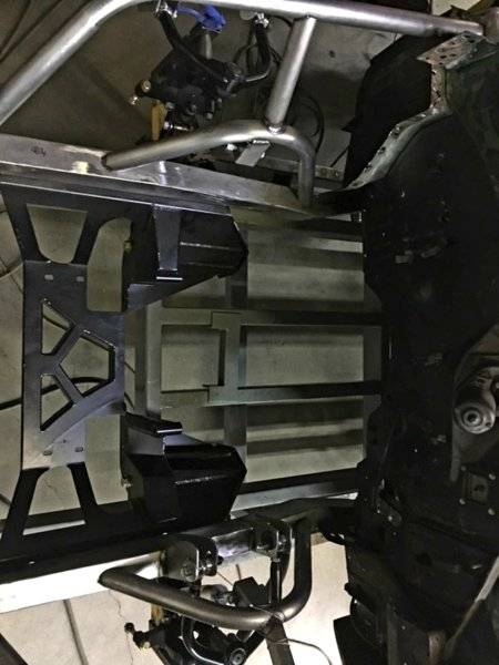

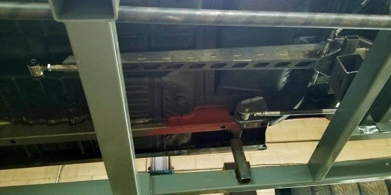

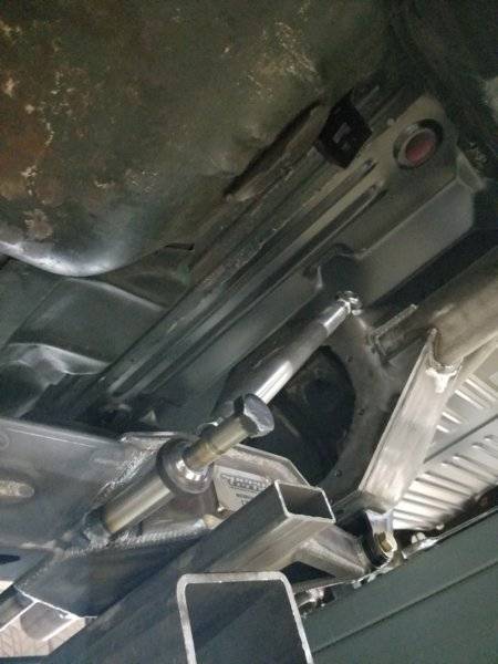

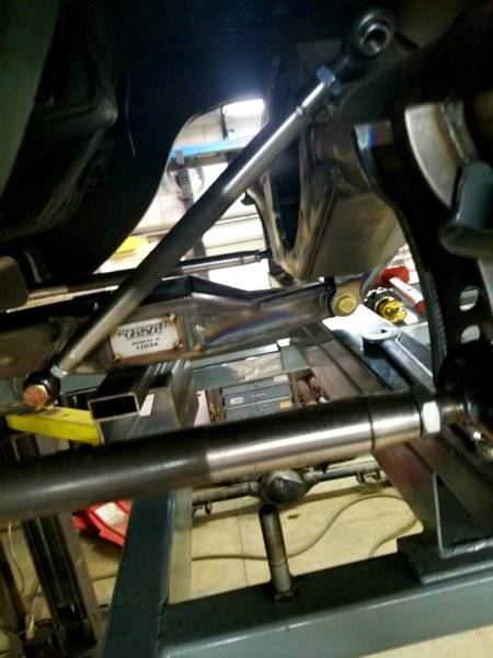

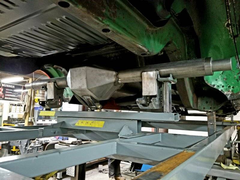

Some pics of the torque arm setup coming together. Using the Speedtech arm but they don't make a full kit for Mopar so making it work!
20180425_101738.jpg 20180425_101238.jpg 20180425_110317.jpg 20180425_131237.jpg 20180425_131258.jpg 20180425_181142.jpg 20180425_181228.jpg
That’s the first torque arm conversion I’ve ever seen in one of these old mopars. Pretty cool!
