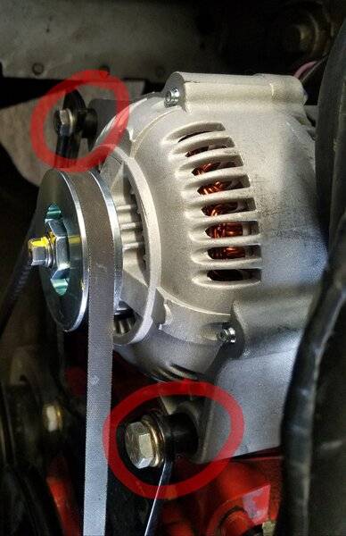

I got my new Denso alternator installed today. Bolting it up was a matter of adding some spacers between the brackets and alternator. Original brackets were un modified.

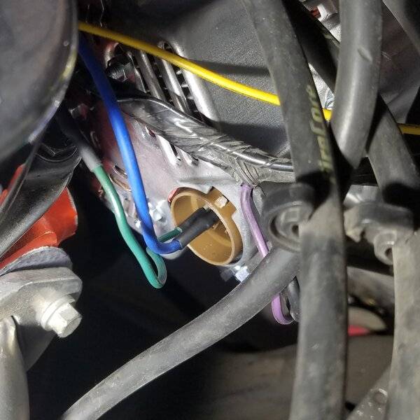

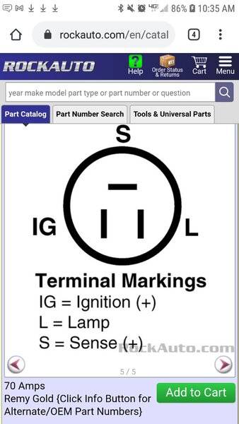

I have a 3 prong plug for the alternator lost in the usps abyss so I plugged the wires in directly. The blue sense wire goes right to the battery. The ignition + goes to the old green wire.

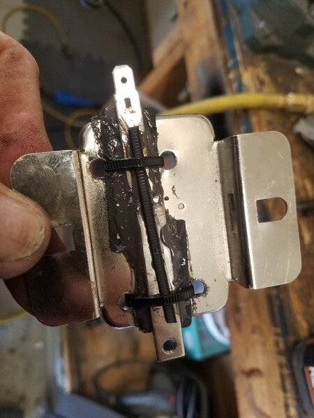

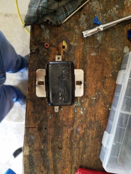

And I gutted my VR. I welded the two terminal ends together and epoxied them onto the non conductive pad and zip tied them for extra insurance.

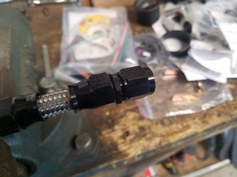

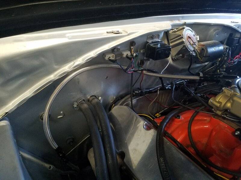

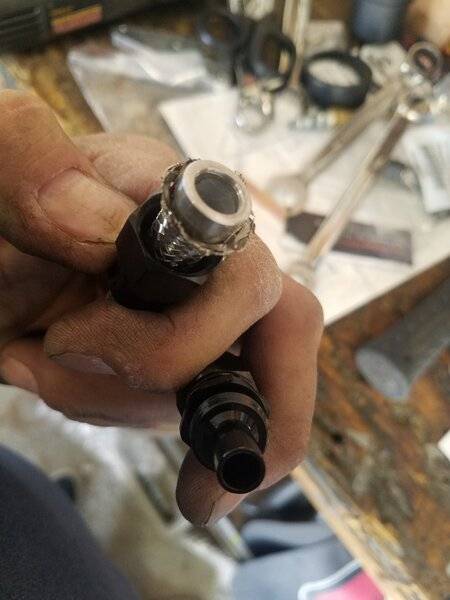

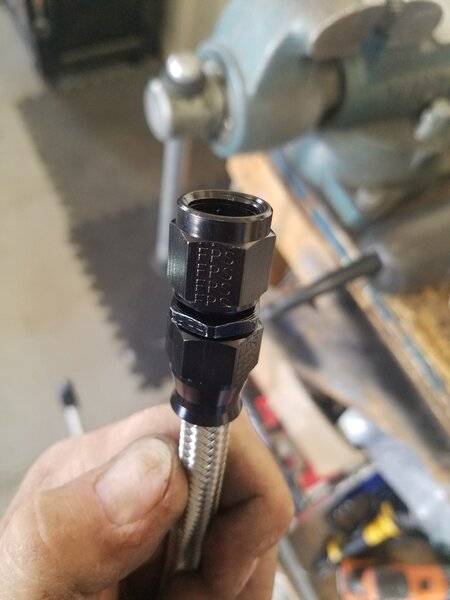

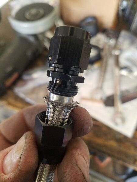

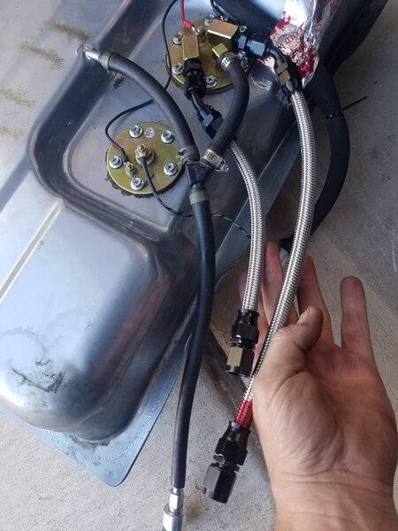

Well, I got real good at taking the gas tank out. :BangHead:. Worked to get the new ptfe line and fittings in. The engine side went smooth. This hose is very east to work with and no issues.
View attachment 1047406 View attachment 1047407 View attachment 1047408 View attachment 1047409 View attachment 1047410

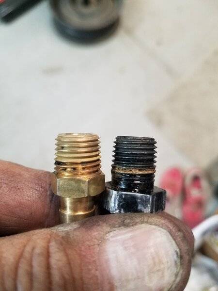

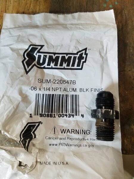

Had a ton of issues on the 1/4npt to 6 AN feed line from the tank mount to the hardline. Kept leaking. Pull it down, take it off, repeat. Pulled out my magnifying loupe and checked the weld for a crack. It was tight tight. I even ran my npt tap into the mount and tried again. No dice.
Finally pulled it, put in the brass barb that I took out and no problems. Has to be the fitting I bought from Summit. The return side is sealed.
I smell like gas.
That bastard on the right...
View attachment 1047411 View attachment 1047412
Brass fitting seals fine. Does the Summit fitting look like npt or straight thread?
I know I'm late on this, but that may be a bulkhead fitting (straight this).
And although l buy a lot of stuff from summit, I would never buy their house brand for anything critical.
That was my thought initially. It just wouldn't seal no matter the amount of sealant nor how tight it was. The brass fitting went right back in, same sealant, and has been leak free. Definitely an issue with the Summit fitting. I'm leaving the efi hose in there until I HAVE to pull the tank. I'm just glad to be past it.

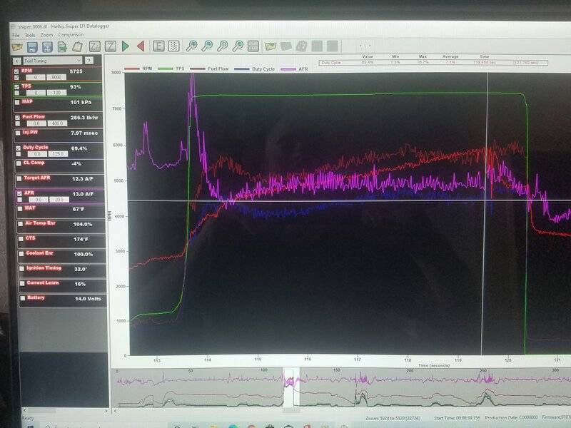

SWEET!!!! So if I'm reading that right you're only at 70% of max the system is capable of? Room for more HP!
