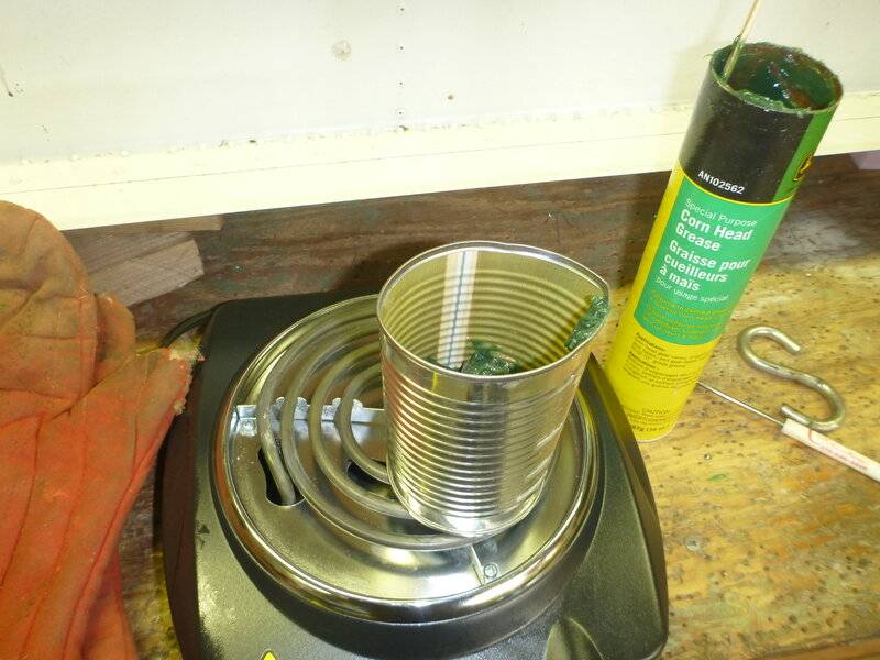

Use John Deere corn head grease. It works very well in that application.

The Corn Head grease is a 0 spec grease that pretty much turns to liquid from the heat of the engine. Is what boxes were filled with when built, 0 grease. The FSM maintenance notes 90W oil. This is for top up only and probably to emulsify old grease. I too filled my freshly rebuilt Bee steering box with 80W90 not knowing any better. It likes to weep out around the big adjuster and it's giant lock nut.

Like I said, when originally redid my 67 manual box also used gear oil , never a problem, even one suggestion said lube he used got thin when hot ! Looked it up , John Deere , corn head grease!
