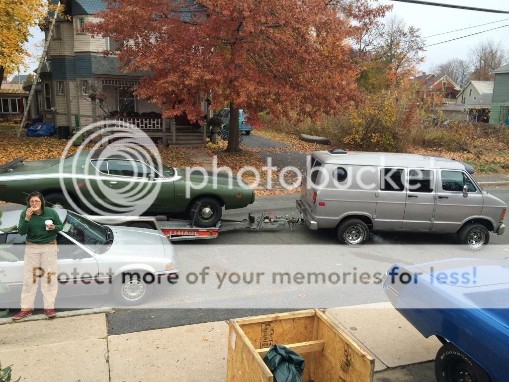

tow dolly pics

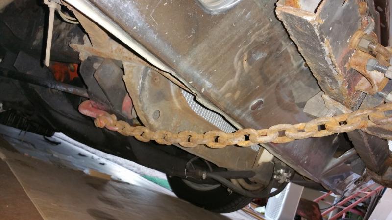

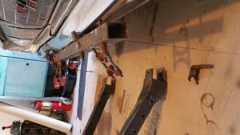

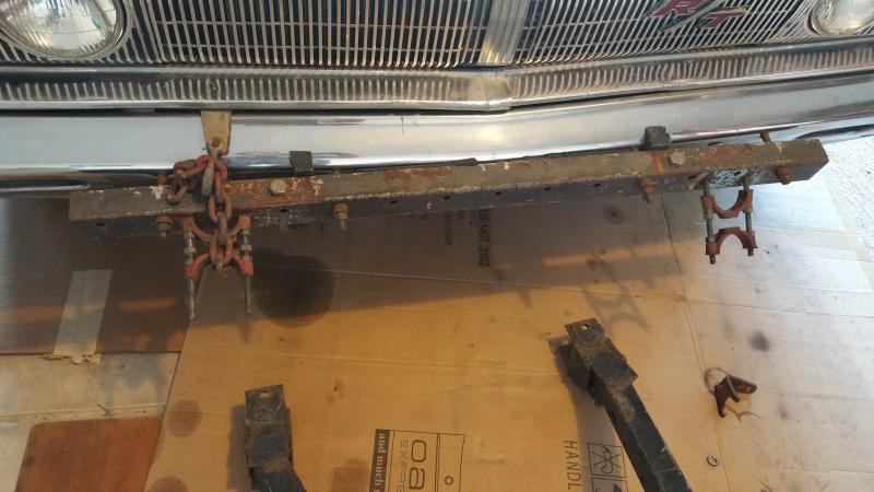

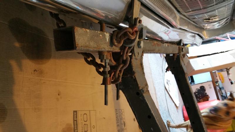

Here are some pictures of the set up I made. It tracks straight behind my Nissan Frontier. Just don't crowd anyone in front of you.
I just used parts and pieces of stuff I had lying around, all but the receiver for the ball. Did you notice the distributor hold downs and rod caps? I use those for added security so that the bolts won't pull through the bumper. I also run a 20 foot tow strap across the truck frame and back to the cars strut rods just for insurance. I hope this is useful.

Keep in mind that eventually (possibly the first time) you clamp a bar to the front bumper, you will likely scratch the chrome.
I shaped 2 hard urethane spacers to go between the bumper and the bar that mounts to it. The insulators also keep the bar in the correct position/angle. You can see the top of them if you look closely at the pictures. These prevent scratching the bumper.
