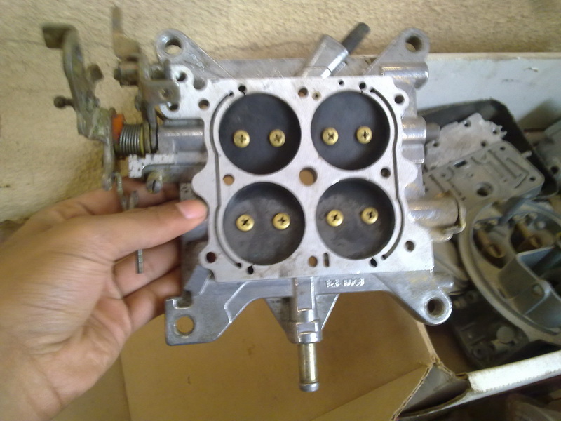

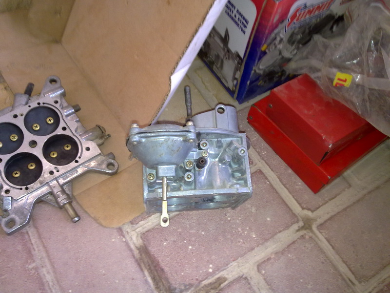

he i got his carb and wanted o buy a rebuild kit but dont know which one it is its a got a number 12r 4770b on the base
there should be a "list" number stamped on the choke tower.
Eyeballing the size of the throttle blades, the booster venturi style and the main body color I'd guess it's a 3310-3 750 CFM. Also the universal linkage and lack of extra vacuum ports goes along with that.
Front right corner.
Right. Top right corner on the outside just above the throttle blades and the venturi. Go to Holley website and look up that list number. Let us know what you have and what it will be used for.
looks like a run of the mill 750 vac. most any decent part store should have a kit for that. just check the choke tower(the ring around the primary bowl) there is the list number on the driver side (linkage) side of the carb.
yup its got 3310-6 on it(on he bowl.....does holey hve a rebuild kit for this?
Yes , you should be able to buy a kit for that Holly at your local speed shop , or on line from someone like Summit or Jegs. Good luck,
