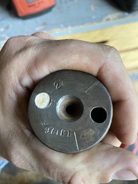

I bought my car and it had this cam with a brand new box of roller lifters inside the car. I cannot seem to find any information on it, the previous owner passed away. Can anyone help me? The car has a 318 in it.
The number on that end is usually the cam core number. There should be numbers on the front end of the cam.
Is the cam a roller, or a flat tappet? If you can't tell, post a pic of a lobe, we can tell.
With no numbers, or even a brand, its possibly a late model stocker, or a regrind . The only way to find out what it is is to put it in an engine with a degree wheel and a dial indicator and measure. You can maybe get a vague idea, by measuring the lobe across the base, and then across the lobe, and multiplying by the rocker ratio, to get valve lift.

That's what I figured. Thank you!
just do a base circle calper check to see if a regrind
check the base against the lift and report
