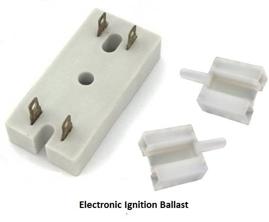

Ballast resistor doesn't have a "backwards" sense. Resistors are bidirectional. Unless we are talking about dual ballast, in that case resistors could be reversed, but still plugs have a key and ceramic got a slot to prevent that. Unless plugs are without the key
That's exactly what it was.
But something was wrong there because the key on plug and the slot on ceramic won't allow you to conect them backwards. UNLESS, the key is broken on plug, which is posible because being old and the heat on the ballast causes to brittle and crack.
When I say backwards I say up and down, not side to side. Side to side makes no difference.
Replacements are available around
https://www.megapartsusa.com/proddetail.php?prod=102-Q1
And save that mistake again.
