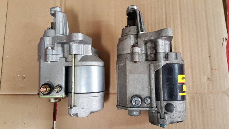

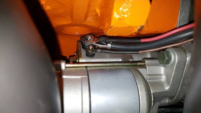

Starter #1 from some internet company was drop shipped to me with a bad motor.
Starter #2 from Summit P/N 820337 would not work because Batt cable terminal was waay too close to the engine block. See pic below.
Returned it to Summit and they said to use the Powermaster 9513 which is adjustable.

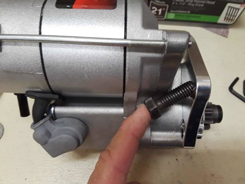

Ok, I got the PWS 9513 and when I went to install it, guess what, the friggin mounting hole is blocked. You can't get the mounting bolt can't through! Check this out:
SO, here's my question, does anyone make a lightweight starter that will actually FIT and work on stock 383 engine? I'm sure some of you guys have been through this process. I could sure use your advice about now. Thanks, RRDon (frustrated)

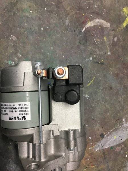

I bought a stock '90s Dakota starter. I cut about 3/16" off the terminal for better clearance from the block, just piece of mind. The big Jegs wouldn't clear my headers.

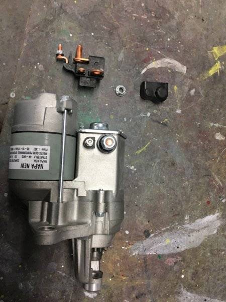

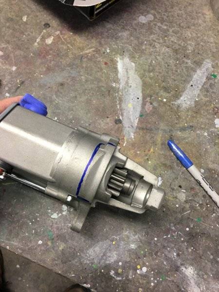

Doing that right now in a 68 road runner with 383. Bought a starter from Napa for a 91 Dakota with 318. Same starter I used in my super bee, road runner, challenger I had and the same starter my neighbor use in 4 of his mopar muscle cars. I’ll post pictures for others to use for reference.
It comes like this.
Remove black cover and remove the post relocation bracket.
On my super bee, I had to grind where I marked with blue marker to make the mounting holes lined up. Not sure if it was my block or the starter I got some extra casting material in that area. Never had to do this to all the other starters I put in.

Doing that right now in a 68 road runner with 383. Bought a starter from Napa for a 91 Dakota with 318. Same starter I used in my super bee, road runner, challenger I had and the same starter my neighbor use in 4 of his mopar muscle cars. I’ll post pictures for others to use for reference. View attachment 662744
It comes like this.

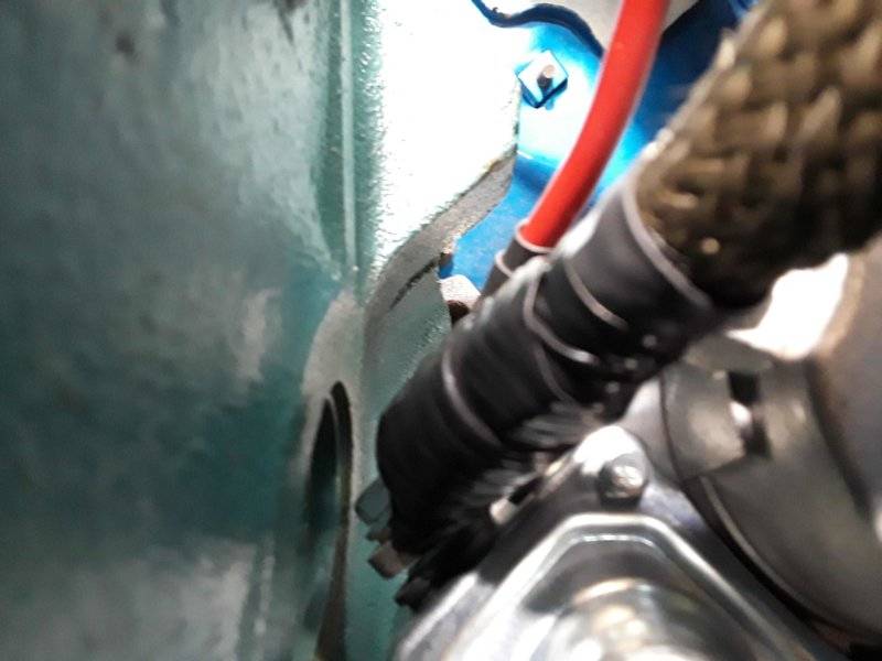

Had the same issue but cleaned up some casting on the block instead.

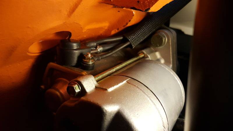

On both starters I ground the larger terminal down a bit for more clearance from the block. And even with a mini starter I still need to remove the header to get the starter out.

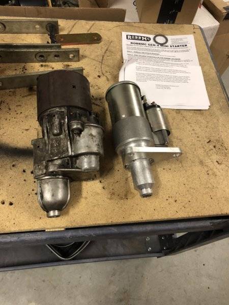

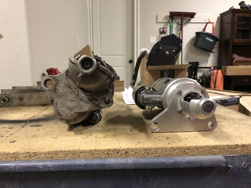

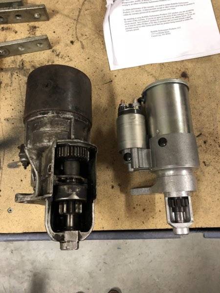

Just got my Robbmc starter, infinate clockability, light, so small its cute, ill let you know how it fits after the weekend...
