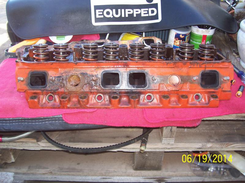

Just a suggestion, I bought a set of 906 Aerowheads from Indy a few years back. I never thought of looking at what kind of freeze plugs they used. They used steel and now they have rusted through and I am replacing them with brass. They don't allow antifreeze to be used at the track, incase you have a leak on the track, and it never gets that cold out here. A lot of labor for a $2 part. Freeze Plug repair 012.jpg

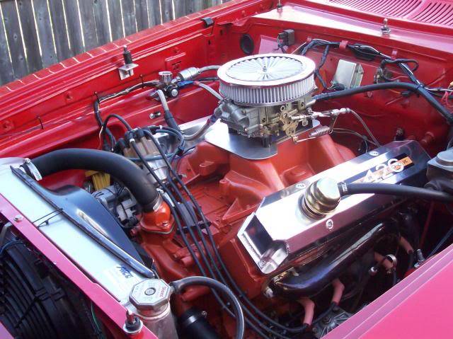

I know what you are talking about on the valve covers as I used the stock type at first on my EZ heads and I had to grind some of the outer lip that is about 1/8" deep so the gasket will sit in there and line up the bolt holes. But later I bought these covers from "Mancini" and they work great as they have no lip because they are flat on the bottom where the gasket goes just like the cyl head is. I bought the Moroso blue valve cover gaskets that are a rubber coated steel insert and they can be used over. It works great like that with two flat surfaces and the rubberize coated steel insert valve cover gaskets. No leaks at all.
I also use 2" TTI headers with my EZ heads and the wires fit on the plugs gear with plenty of room for the plug wire boots with the angled plugs. In fact I think the angled plugs on the EZ heads have more room with the plugs angled. Ron
Here is the valve covers on my eng and you can see how the plug wire boots have plenty of room and the headers are 2" TTI"s. Ron

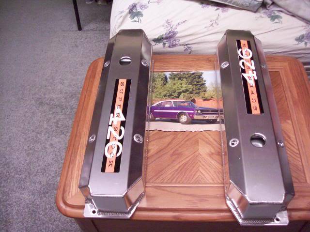

You know this just made me remember my brother uses these Indy valve covers on his 511 (400 stroker) and he uses the same blue Moroso valve cover gaskets as I do and I know they wont work good on a stock type valve cover with the lip on them so they work good on his eng with the Indy valve covers so they should work fine for you on yours. Here is the Indy valve covers he uses. Ron

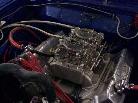

Your motor looks great, sounds great!
Very Nice! You'll have fun with that for sure!
