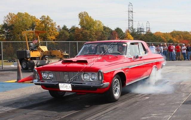

I would contact Nick Wilson at www.Compu-Flow.com and get a set of ported Indy EZ's
He can also spec you out a cam to put your where you want to be.
I am just a tick over 600 HP with a mild flat solid cam with my 493" with a set of Nick's heads.

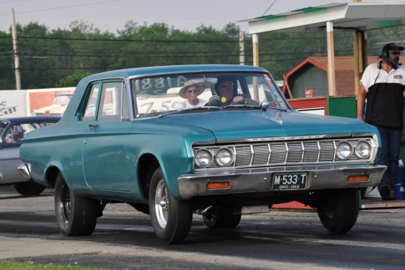

My 493 combo is close to Gus's (Fourgearsavoy) as I use Indy EZ heads and I got mine from Dwayne Porter for a great price. I believe Indy has them for about $1800. now. I also use a flat tappet cam speced by Dwayne Porter also. I went with the EZ heads over the Eddy RPM heads because the EZ heads have more potential if I want to step it up some later. You can see my 493 build at the bottom of the page when you click the link if you like. Ron
