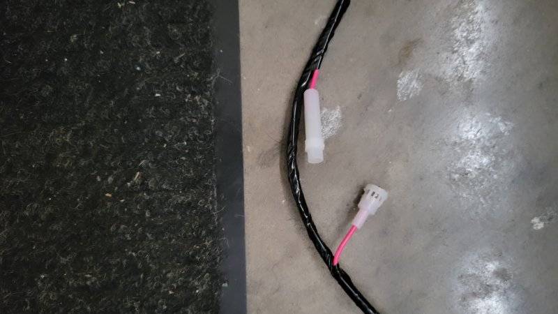

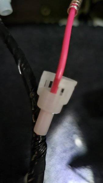

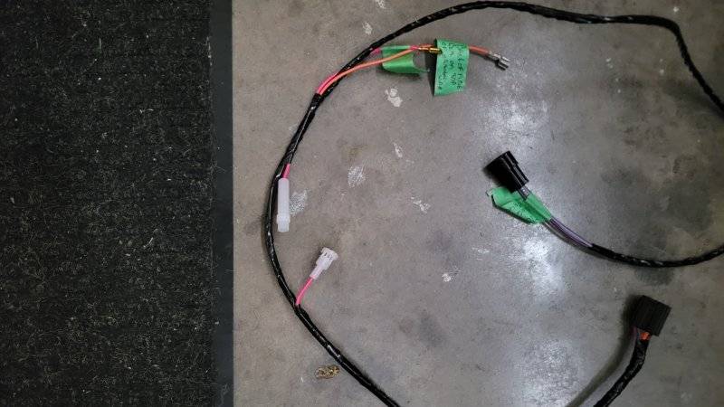

If you have this cheap inline fuse connector it will fail. I replaced the kick panel harness fuse with a blade type fuse, using crutchfield twistlock connectors feeding the console lights. The extra kick panel harness i have, the fuse connector failed just sitting on the shelf. 1967 plymouth belvedere.
