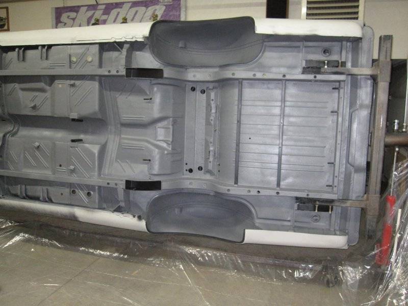

Epoxy primer. I did the entire bottom with it and then top coated with Raptor bed liner-tinted gray.
Mike
