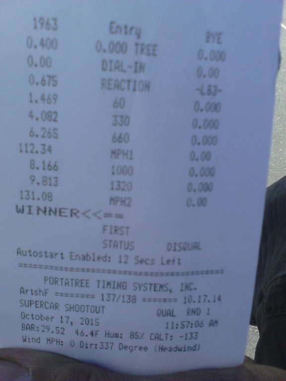

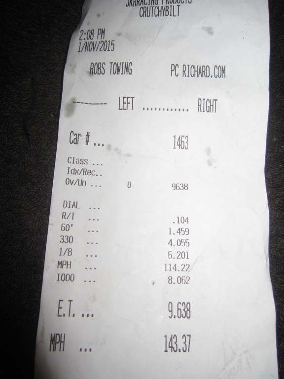

I'll skip over the next chapter or two and post my last 4 passes.
5 years since I reinstalled and taking baby steps:lol:

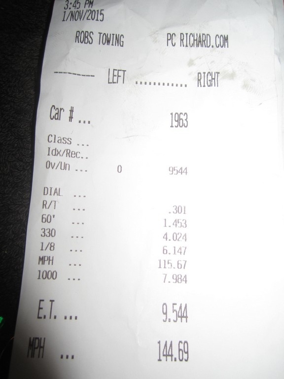

60 Foot1.27
330 Foot3.68
660 Foot5.78
660 MPH117.63
1000 Foot7.60
1/4 Mile ET9.16
1/4 Mile MPH144.69

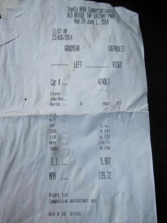

Here's where your incrementals will be if you can get it hooking. I plugged in your mph into the Wallace Calculator. Looks pretty good!
LMOL,my 3850 lb brick will never 60 foot that fast with the tight 3000 rpm converter I have. Picked up a 1/2 a second with some tuning and now fine tuning.When I get it right and consistant,then I can start changing pullies to get that 8 second time slip.
Not to shabby for a toy I street drive with!

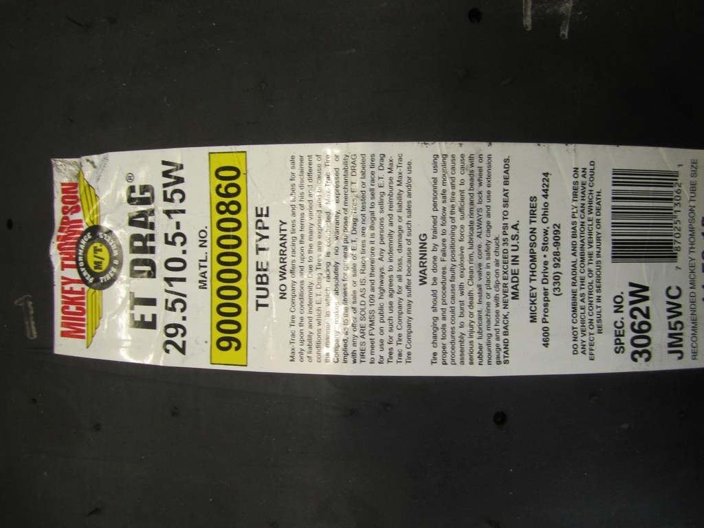

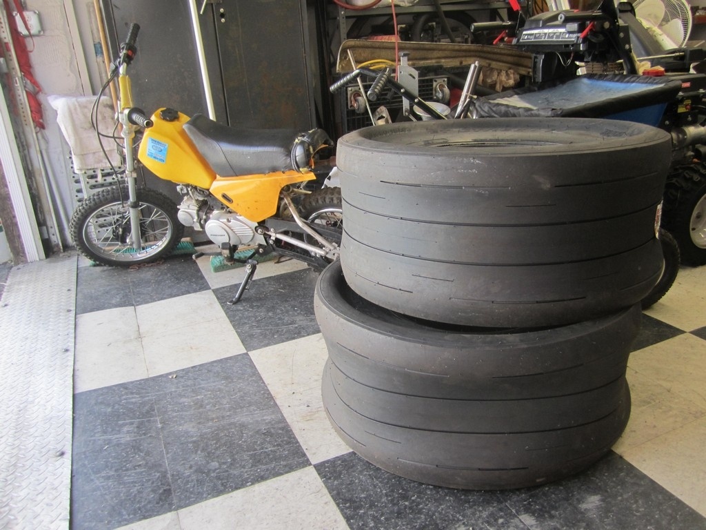

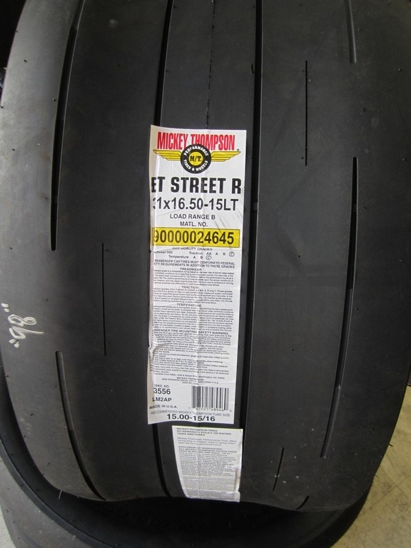

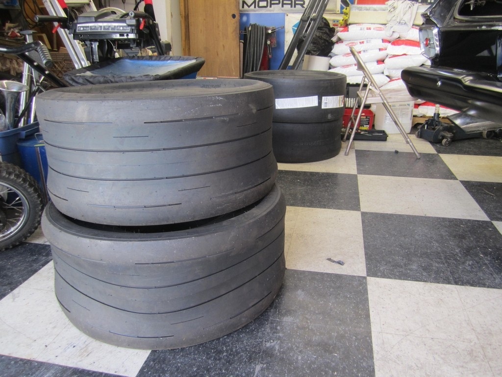

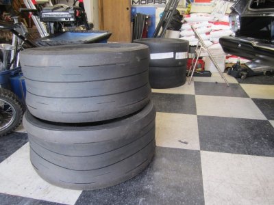

Just picked up 2 new sets od rear tires,2 eT street R's & 2 ET Drag.
Still waiting for the double bead locks from Champion.
