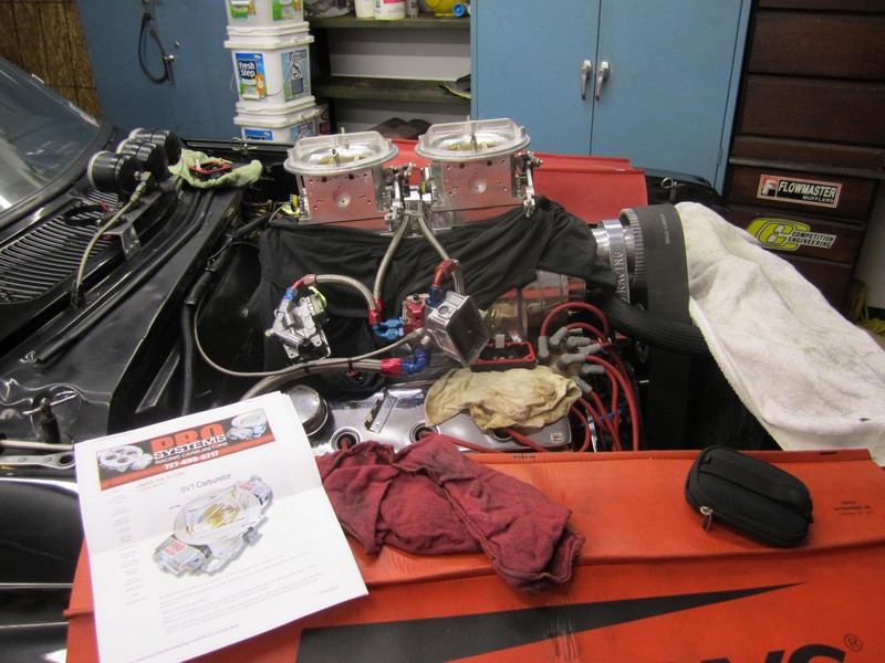

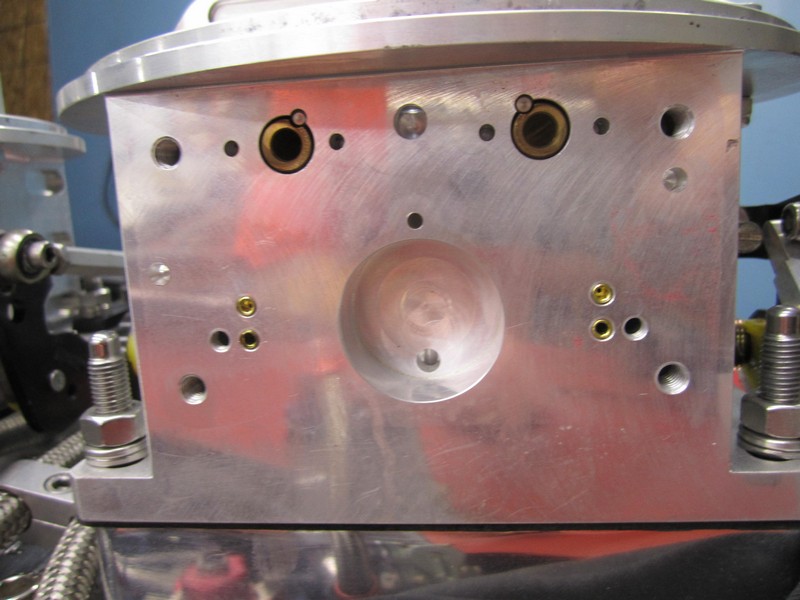

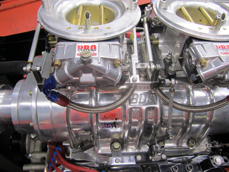

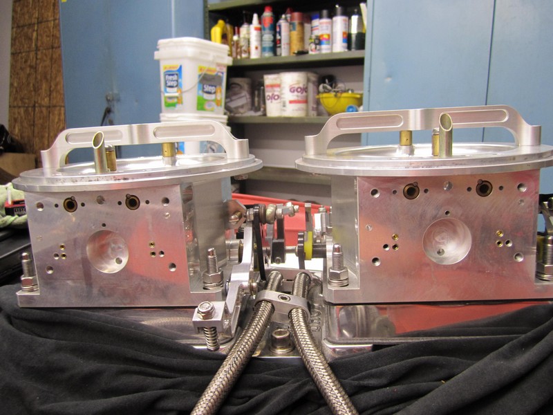

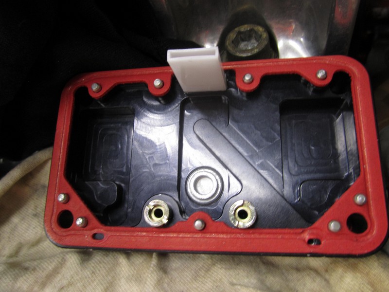

I have a carb stumble on the tip in,so I called Pro Systems for tuning consult.Added more fuel and went smaller on the air bleeds.I'm also adressing the linkage to obtain FULL throttle,I've been cruzin with 80% and the stumble.Got the carbs back together but I need a longer throttle cable.I'll go see special "K" and pick one up tomorrow:happy7:

Those are Impressive caruretors...
Thanks Bud! Installed a longer OEM style cable and stll can't get full throttle:angryfire:Also the effort required to pull these carbs off idle is causing strands of the throttle cable to break and unwind.I trimmed the ones I saw up top,but did not notice them where the cable comes through the firewall.Friday night after changing 8 air bleeds and taking a test blast,the throttle hung wide open causing a stain in my panties:sideways tongue:It also raised my heartrate and blood pressure.After whackin' the pedal a few times it only came back half way and I turned the key off to shut it down without hitting anything:confused5:
