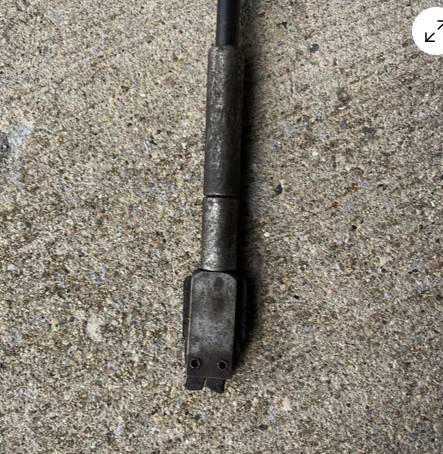

There is a tool that grabs the lifter by the snap ring groove, and you can pull it out without removing the head. An older mechanic friend lent me the one he had, and it worked great to pull a noisy lifter. Snapon, maybe.
I have one.
You need it if there's a varnish build-up.
I'll have to look up the part number and post it if I find it.
This is the same one I have and it's on ebay right now.
I've had mine since the sixties so I would imagine that they're getting pretty rare, now.
