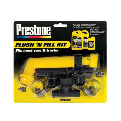

That requires cutting the heater hose to install the kits' T fitting, and the thermostat will still be closed. That backflow may still do the trick though.
Anyone else?
It does the trick my friend. Just install the T's connect a hose to the T push the gooseneck into the radiator opening fire up the engine turn the water on and sit back and watch until it runs clear, your done.
