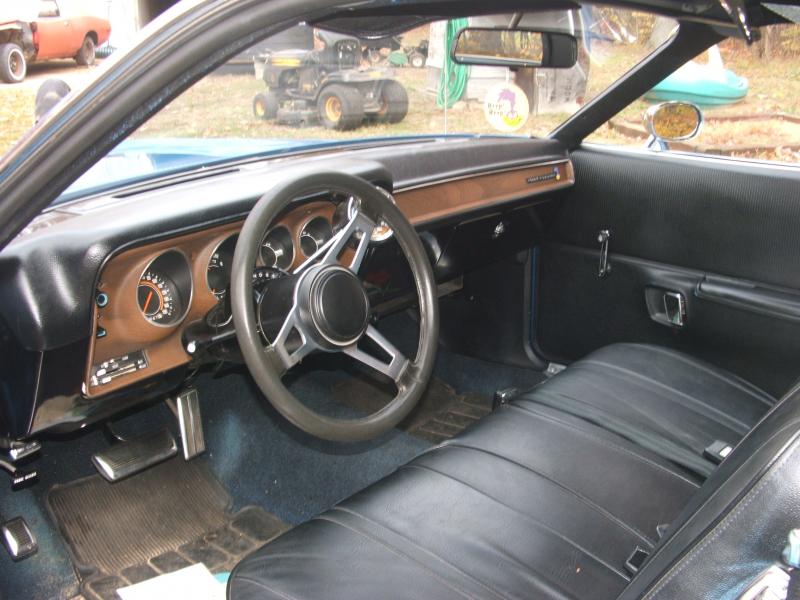

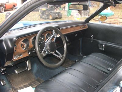

if your going to put one in your car get the right adapter.make sure your steering column has the notch for the can to slide on,have see some early 70-71 cars that dont have the notch.
