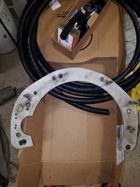

I picked up the TCI 149180 kit dirt cheap at a swap meet. The mounting plate had already been shaped as not to be used as a mid plate.
Now the kit I got was was for an 8 hole crank ( if anyone needs a new flywheel I have one), I have a 6 bolt. The flywheel adaptor is $200.

Here is the adaptor after the plate was shaped.
