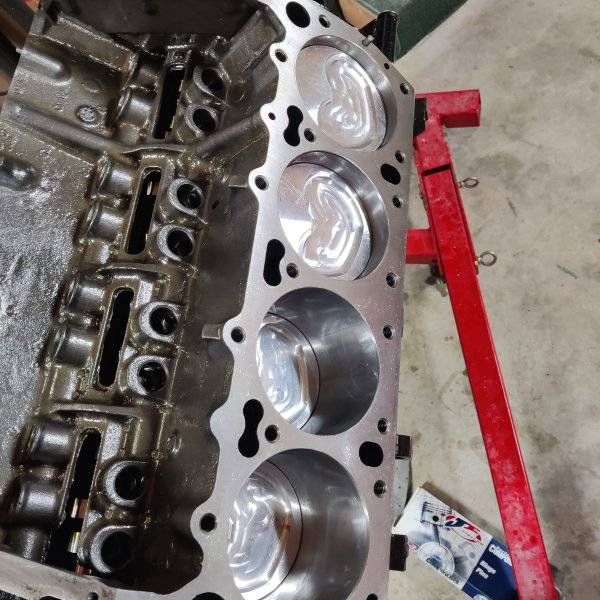

For the people who think I am BS here is the piston at the top of the deck.
I just aligned the dots so maybe..

What is the piston dish volume? Looks like 20 cc plus. Strange to buy a low compression piston only to mill the heads 0.060”.
And, is that piston upside down?
Hi , piston is correctly installed .
Went with this piston because the were what we had left over from another build .
We shaved the head to get up to 10 to 1
Or a little over.
It is very snappy and has great quench.
If the pistons were installed the way they are in this image(I flipped the image) ...BSB67 is absolutely correct...they would be installed upside down. The dish should be where the combustion chamber is. The valve reliefs would be upside down so your valve to piston clearance would be compromised.
Good eye that is not how they were installed that was a quick moc up picture.
Your right I have a picture of the final assembly.
