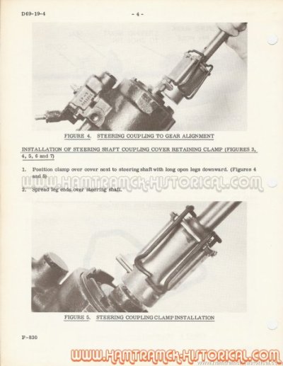

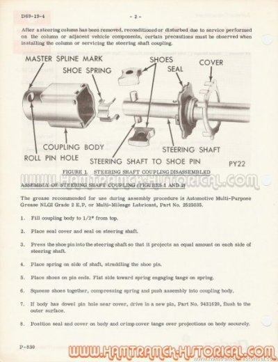

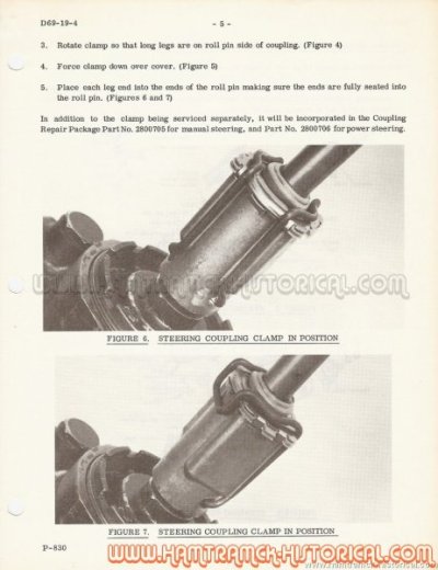

Mopar Dodge Chrysler Plymouth Technical Service Bulletin No. D69-19-4 for all vehicles using the 3 inch overall length
steering coupler whenever the steering column or steering box was "disturbed for any reason."
This was due to the tendency and frequency of the crimped on steering coupler seal cover to come loose whenever
the cover was crimped on outside the factory.
Many cars were coming back to the dealership for service and the technicians were having a difficult time securing
the seal cover to coupler due to the small retaining tabs.
This created an unsafe condition and allowed the seal to come loose and grit and water to enter the coupler.

As has been pointed out it was introduced as a "fix" for service techs that couldn't get the seal retainer plate to stay in place.
Not a single car left the production line wearing one TTBOMK.
And I would highly recommend that you put the clip on, it's not difficult to snap on.
