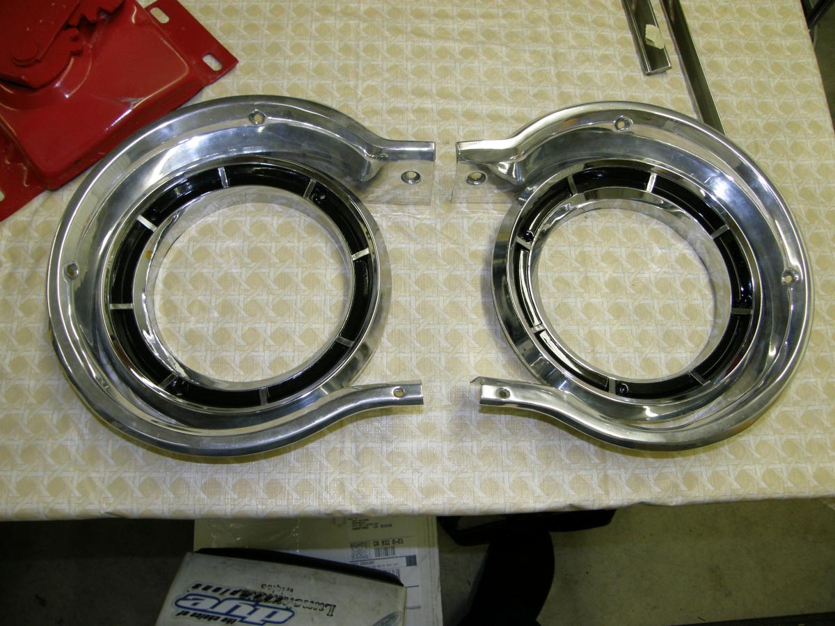

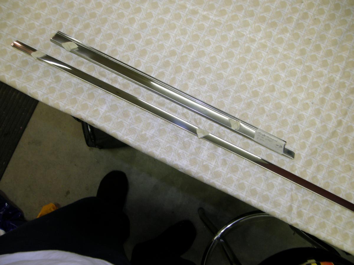

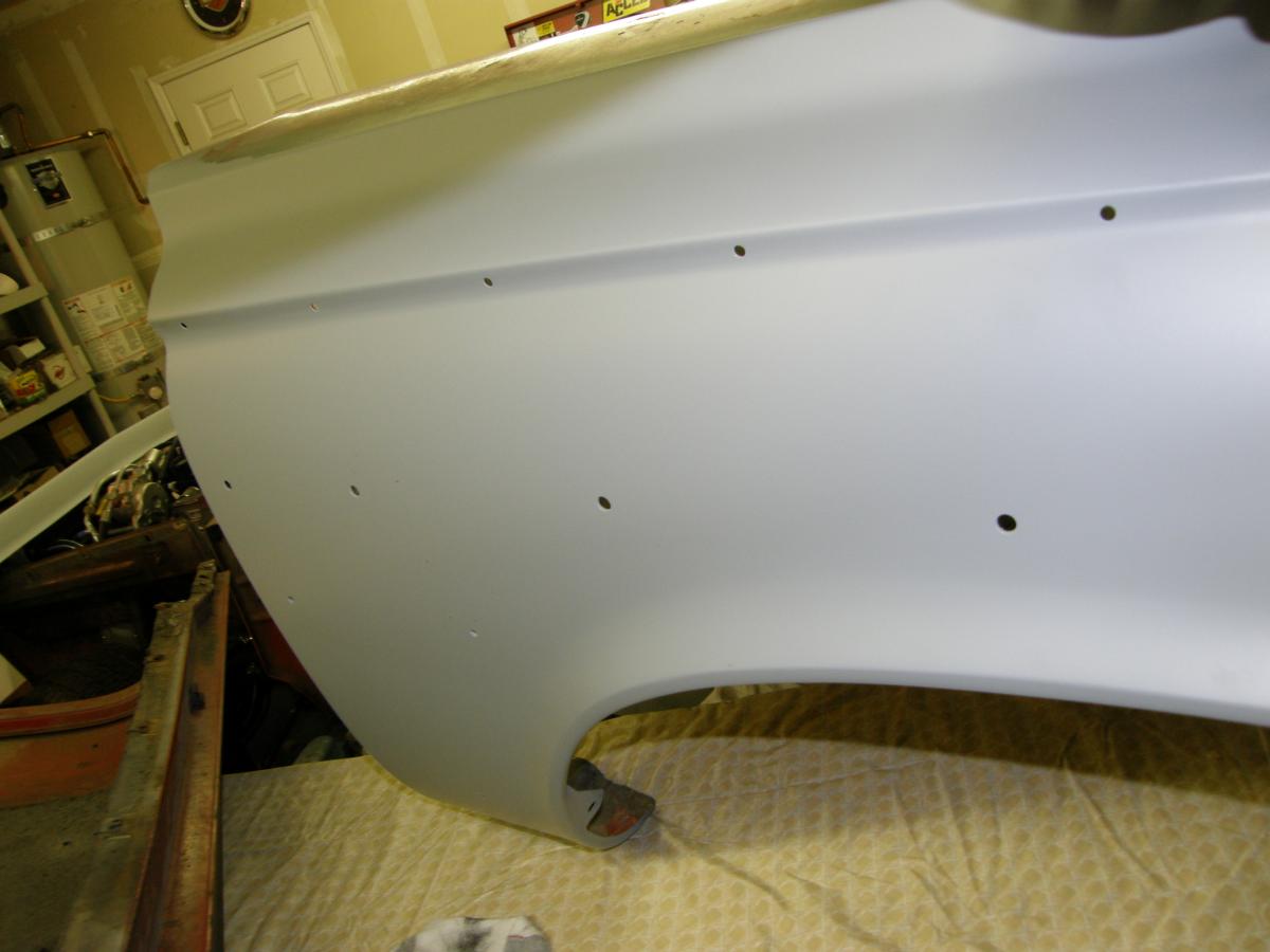

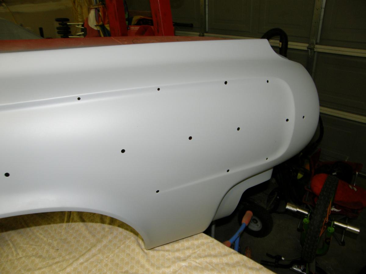

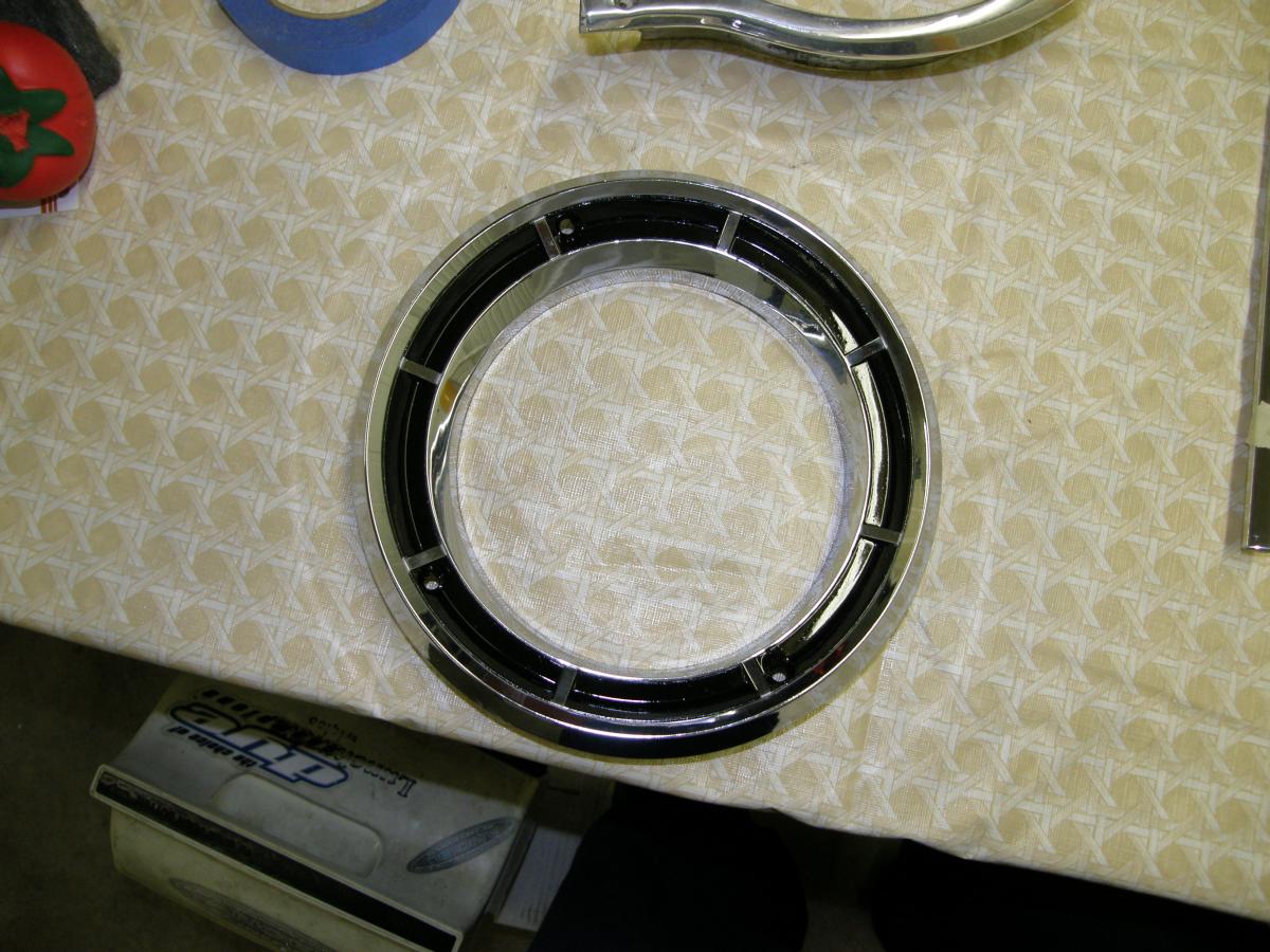

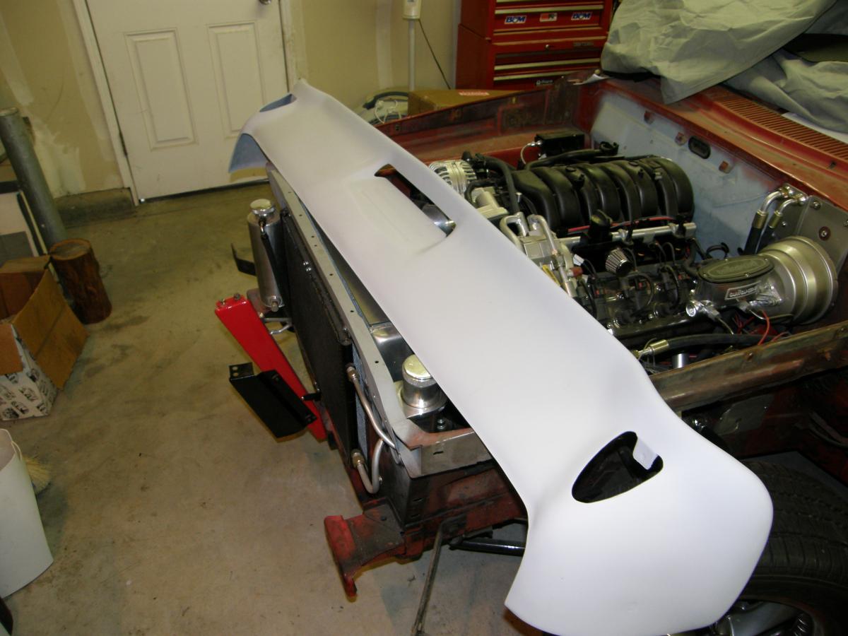

Here are some pics of what I have been doing for awhile. The fender was sent to the guy that did my dads 70 Challenger RT, so I had him fix what I did not have the talent to do. The headlight bezels came out real nice, the C rings were done buy a guy in town 2 years ago--came out great, the dash piece polished up great (ebay item), and the fiberglass bumper is primed and ready for more work. Hope you all enjoy.

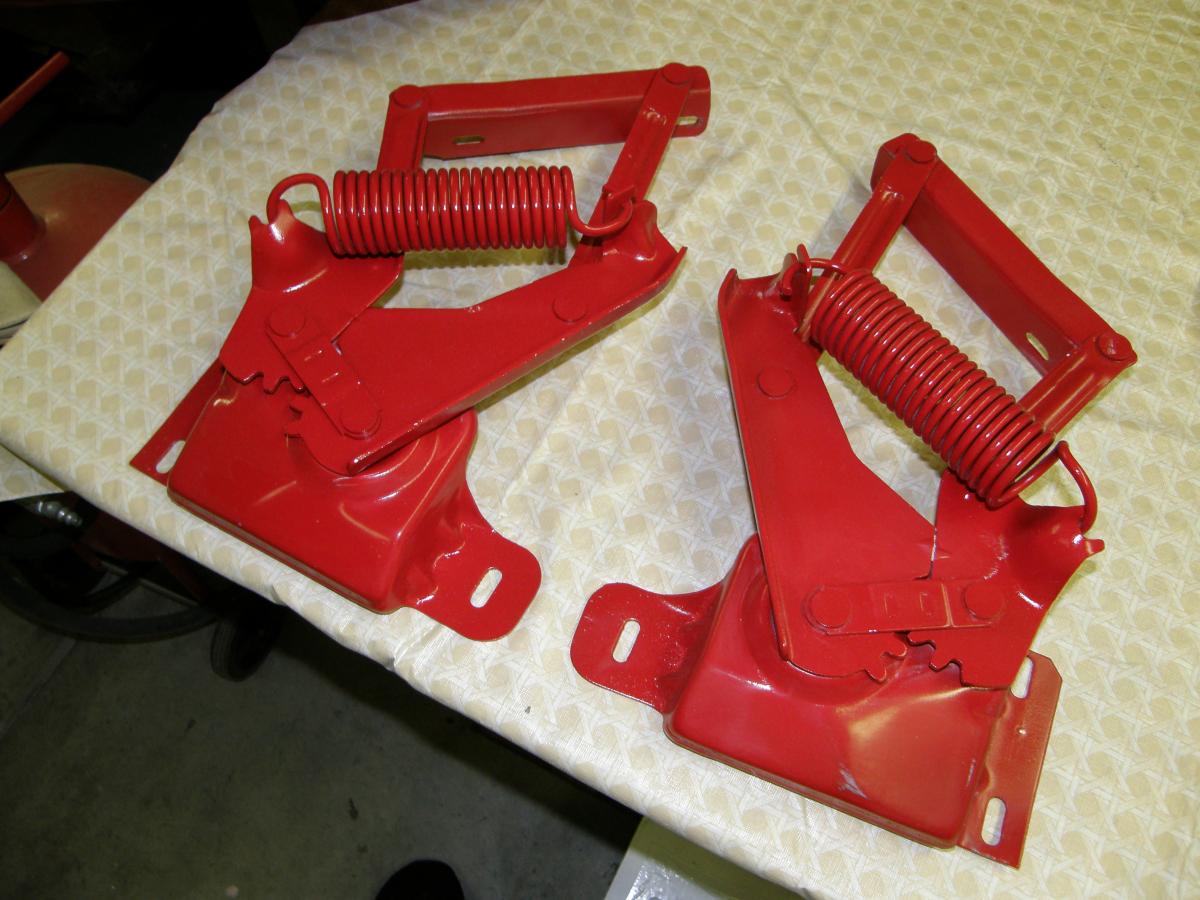

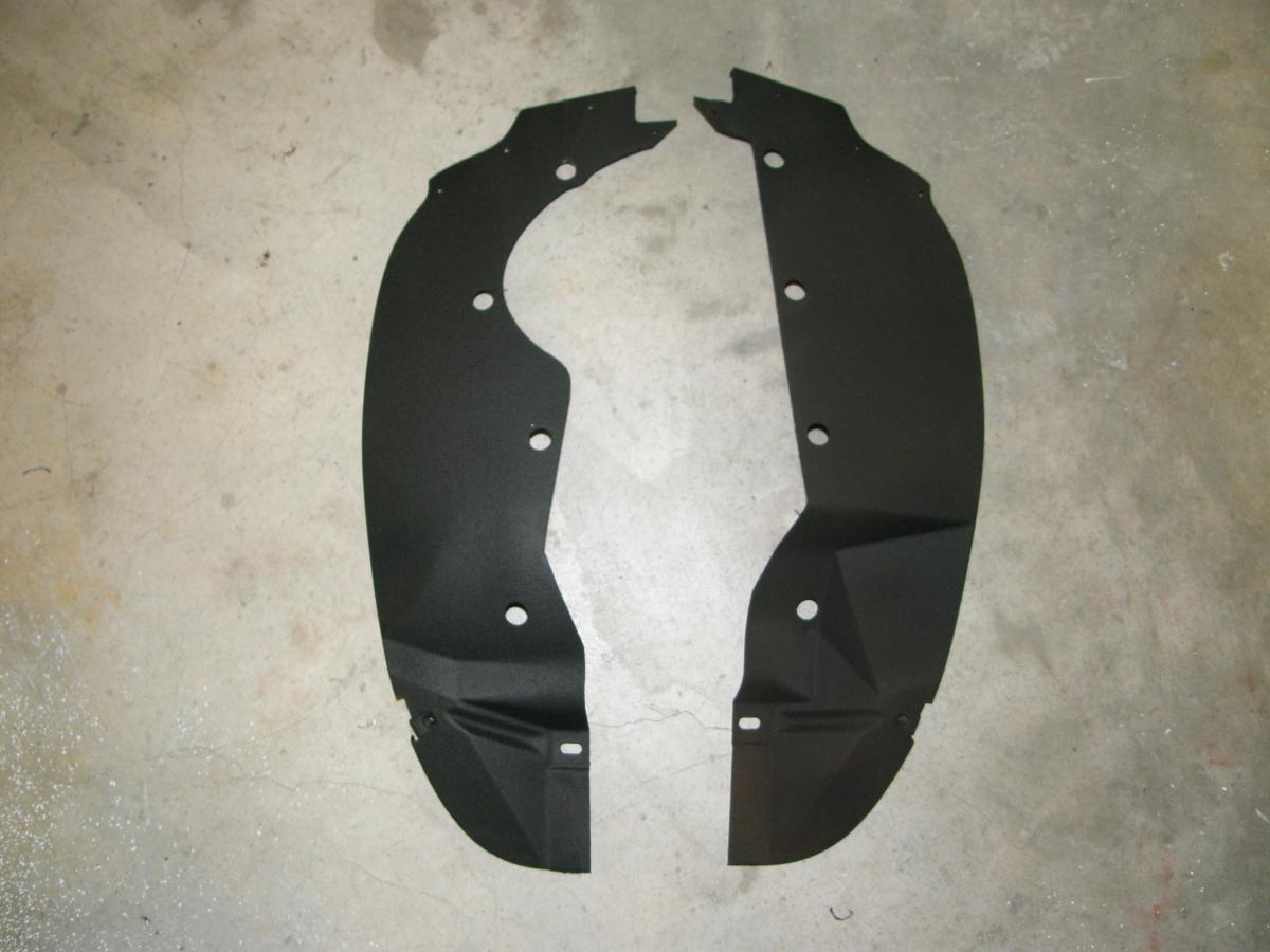

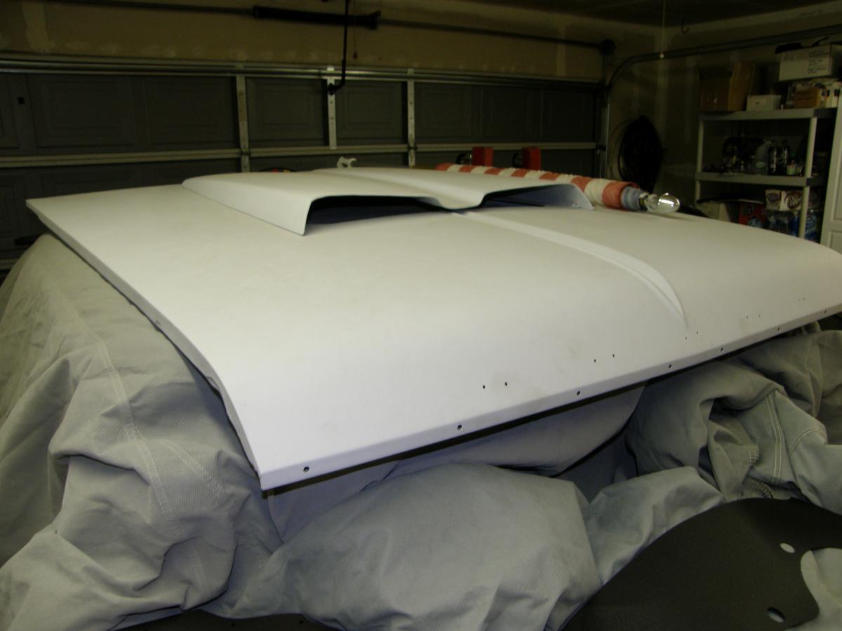

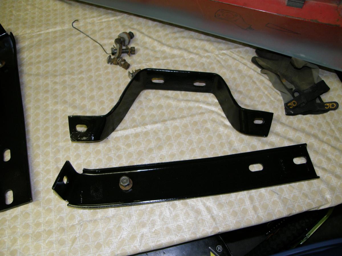

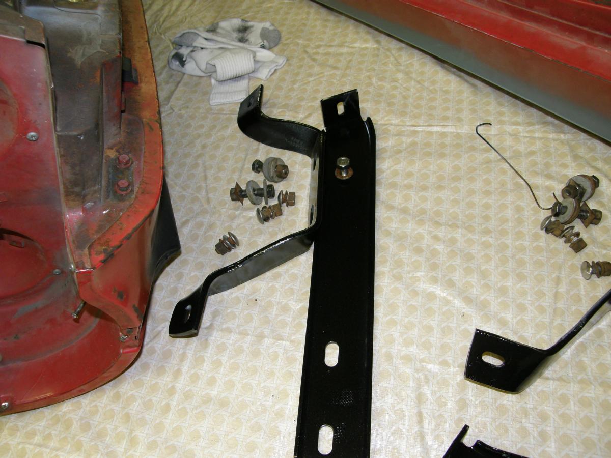

Front rear splash shields done (need to get new seals for them), painted the hood hingesbc/cc (testing the water so to speak), front bumper brackets done, and the hood and scoop are ready for paint.

Oops, forgot the hood hinges.

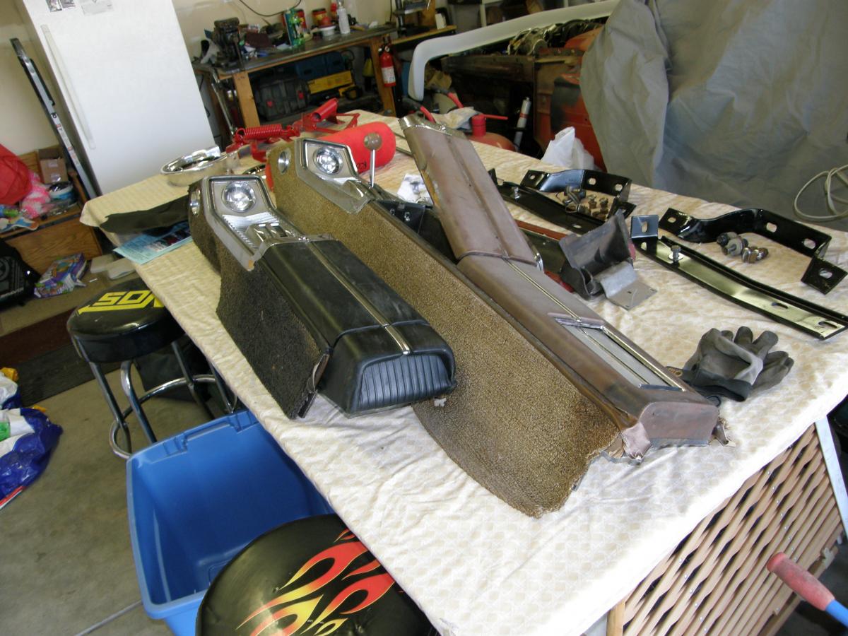

On a lighter note, I scored 2 consoles at Spring Fling, so now I have 3, and will start seeing which one I want to use. I could not believe it!!!!!

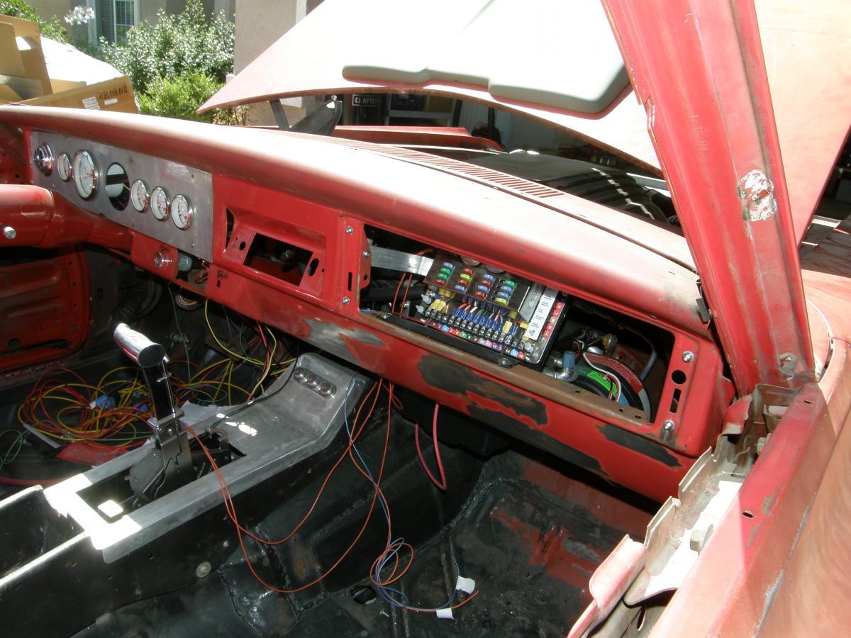

JoeMopar, this is the only pic I have that even comes close to what you want. See the bolt on the bottom of the console, that is the middle location. I'll try to get some pics for ya, it may take awhile, but I'll get them.
looks like a ron francis wiring kit ??? how do you like it???
as for RWH there was A 5.7 challenger at carlisle in 09 a 2009 5.7 variable cam timing is the big difference over the 2003 5.7 only mod he had was a truck in take 330 at the wheels it was on the dyno at carlisle
I like so far, but hell, I've done just enough to get it started, so we will see how the rest of it goes.

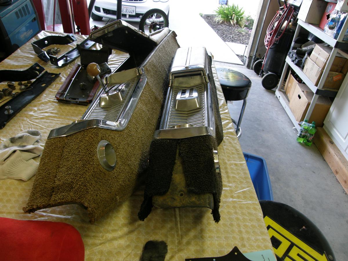

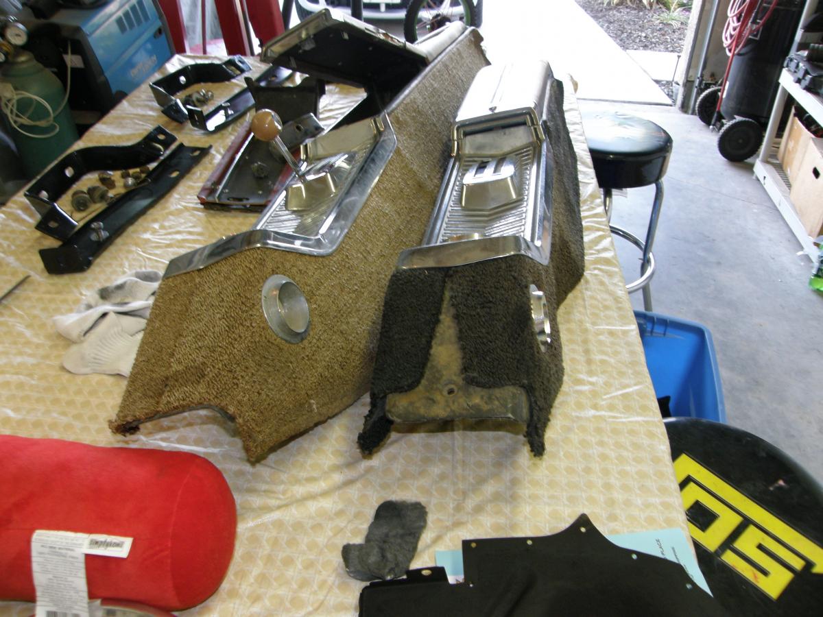

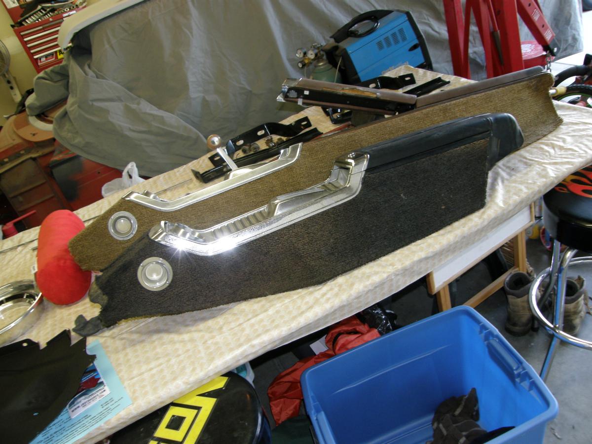

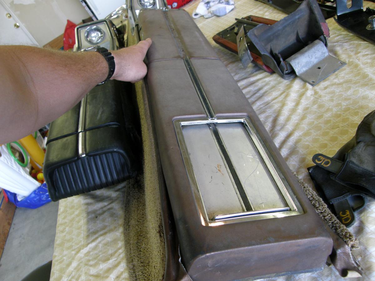

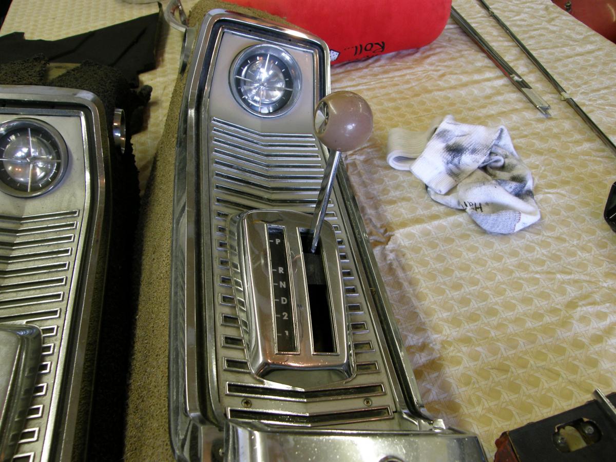

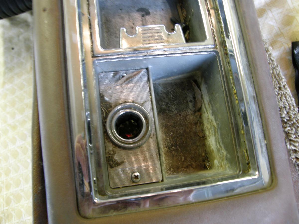

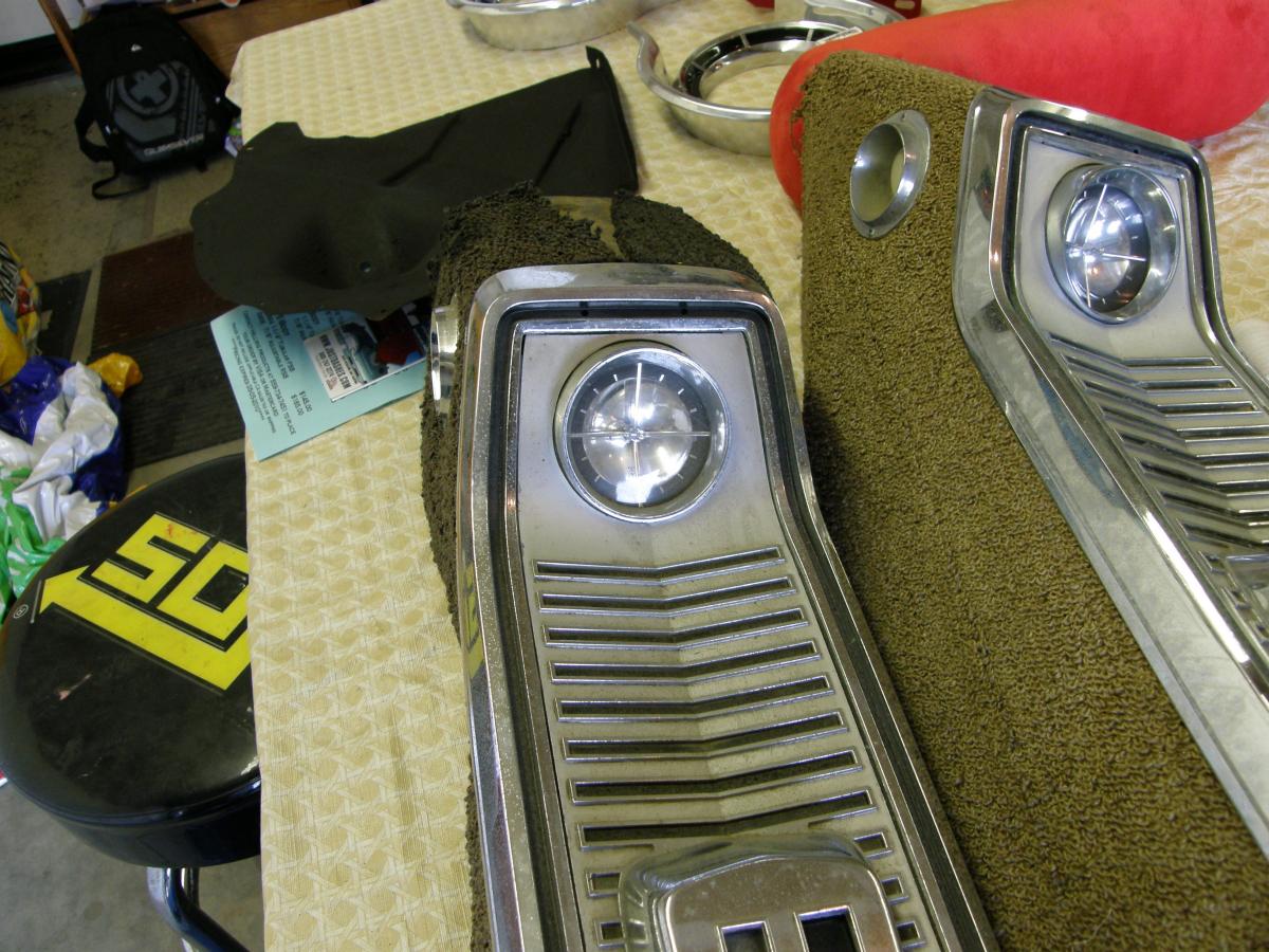

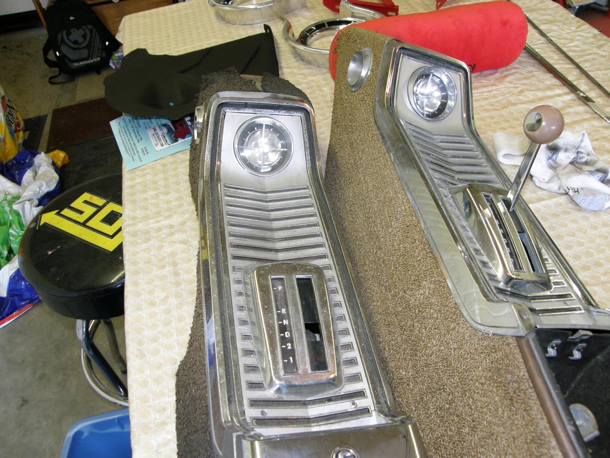

Here are some pics of the consoles that I got at Spring Fling. Enjoy!!!
spring fling must be the PLACE for soem rare parts,,i rememebr that console from my 2nd car 1965 sport fury,383 factory console 4 speed car,,,ever see a 62 ish short console there ?? im thinking one of those may be the hot ticket for my barracuda,,,they are short just a storage box,no shifter location
I saw 2 of them last Oct. for the Fall Fling. Reall easy to miss if you dont know what they are.
