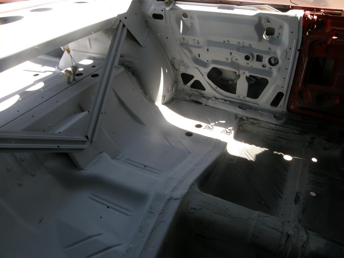

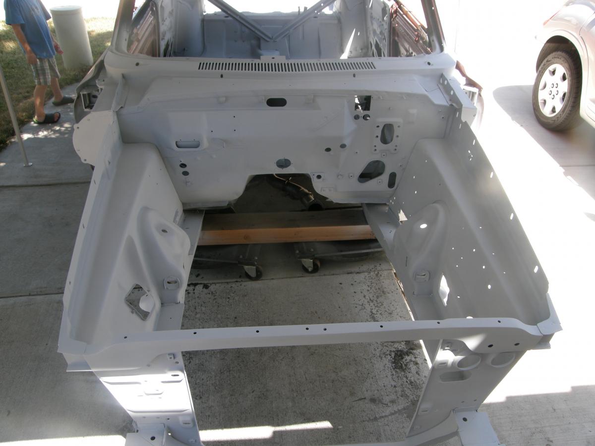

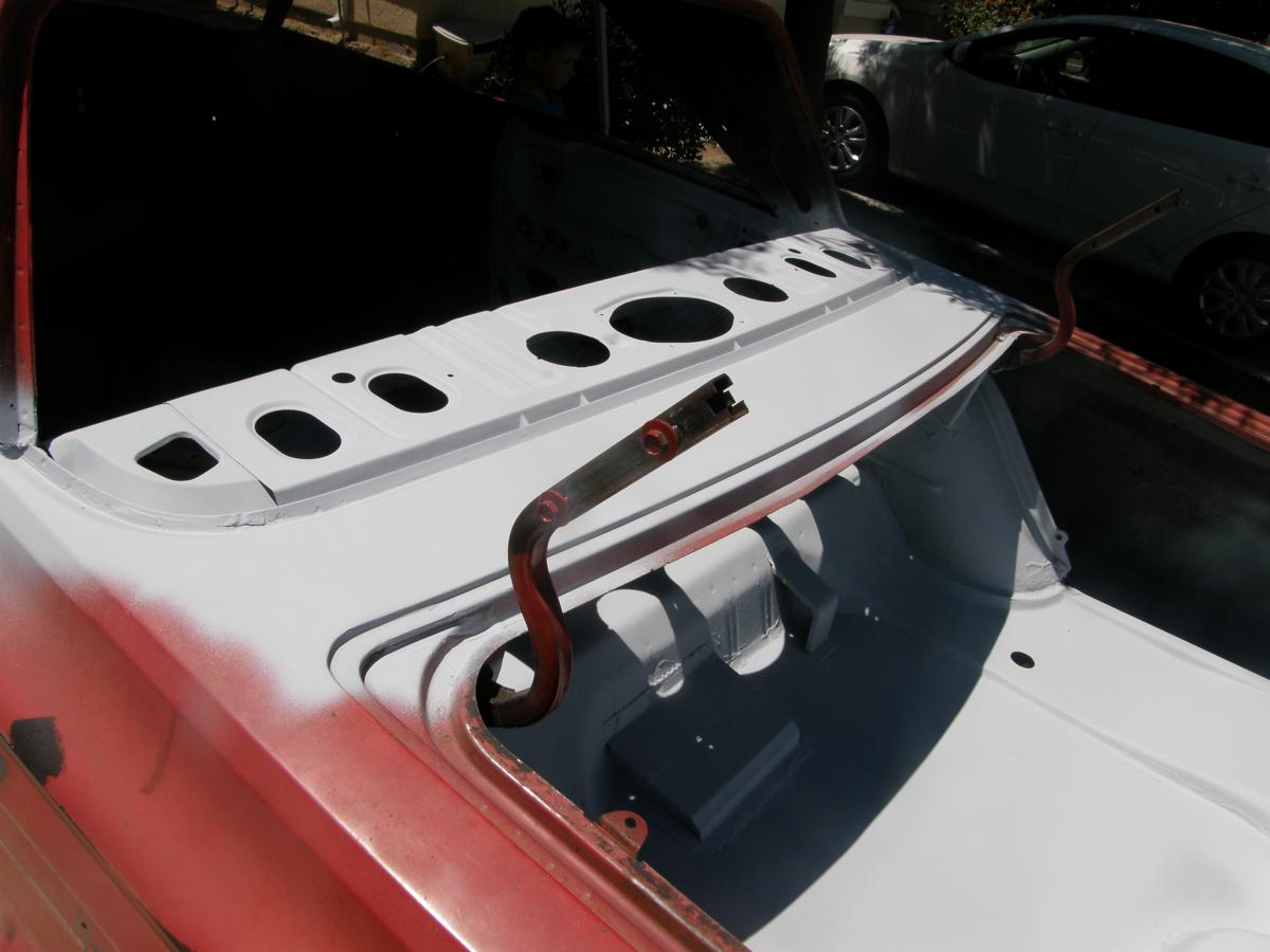

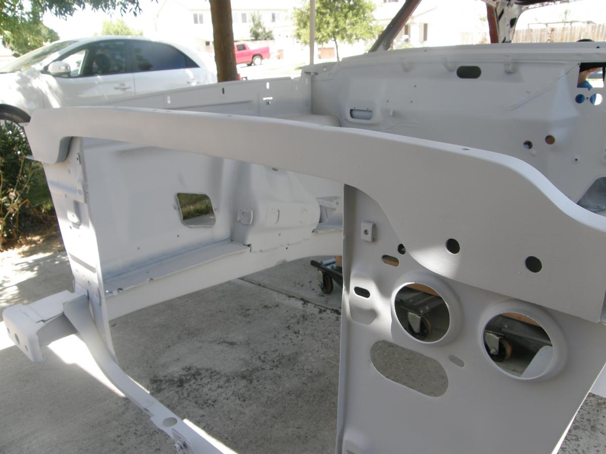

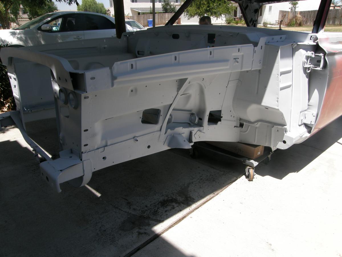

I'll post pics of what I got done this week on Sat. The primer turned out nice and now comes the more difficult stuff, (dents), lucky me!!!
Here are some pics....enjoy.
