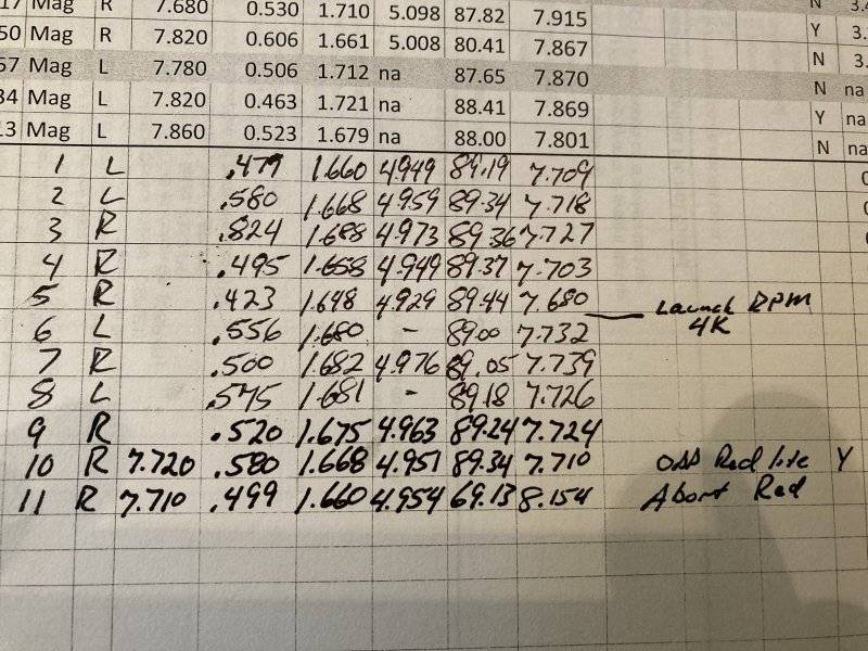

Ouch.Got back out there today.
1. New adjustable front shocks.
2. Back shocks tightened up.
3. 29 inch slicks replaced thw worn out 28’s
I know you are supposed to change 1 thing at a time, but there’s only so much time.
So it worked out pretty good. Car hooked well and handled well.
Consistency came back and I made a couple passes close to my best.
Cutting a light was a challenge and I had a couple ref lights in test and tune, so I cut down my launch rpm a little .
Cut 1 .500 light. I knew that was too close.
Round 2 eliminator I went out .499 red.
Making progress

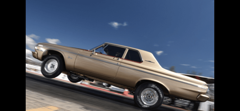

and not happy, but I am adjusting my thinking to do more for myself, because what I've been doing for years is very unfulfilling and too often unappreciated. Oh, and I generally like my work and my customers appreciate me, so conclusions can be easily drawn.Yeah, but that picture still looks AWESOME!Pic for dreadfull memory of never knowing what’s gonna happen on launch. Rear leafs stretched right out. Yanking rear tires off the track as the front drops.
