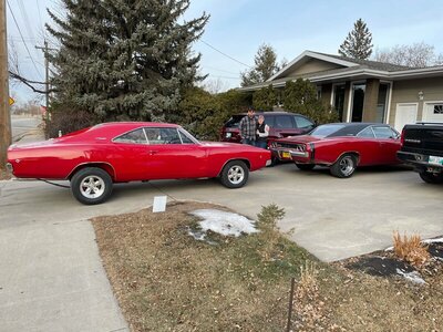

A couple more pics with the Hemi springs.
I wanted the same thing for the GTX. I opted for “add a leaf” from Summit. They’re just half leafs easy to install and very inexpensive it’s been a few but I think I only paid about $38 for them. Can’t remember if that was for one or both. But raised the car the desired 1’- 2’. You might want to check them out.
I have mopar performance super stock springs with coil overs in my car. It’s settled about 1” down now from this pic. Would be another 1” lower with no coil overs at all

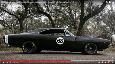

Photo of a Texas 68 Charger after installation of Mopar Performance Heavy Duty leaf springs, part numbers P4452982 and P4452983. Summit Racing sells them for $140 and $153 respectively.
