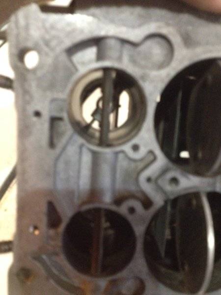

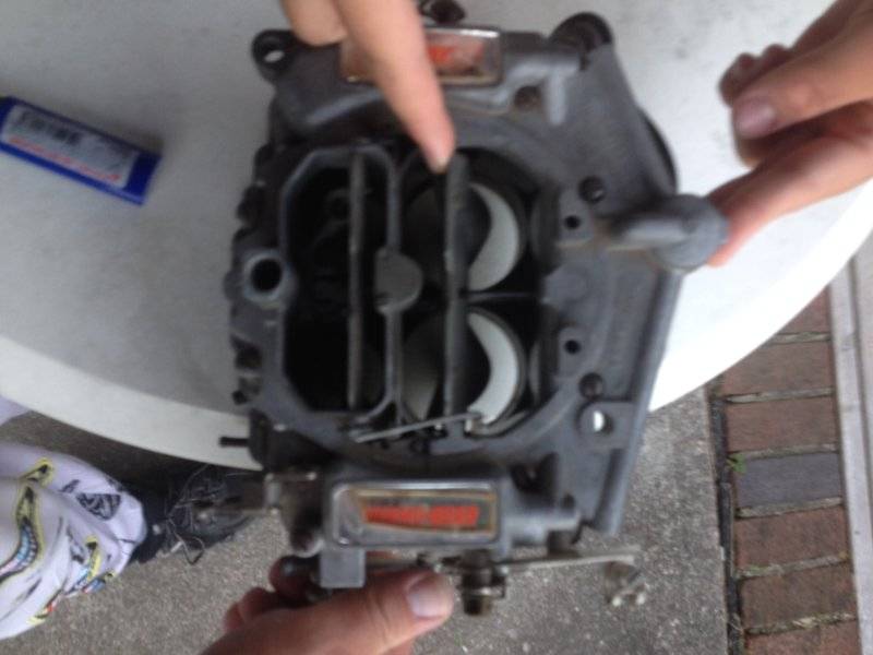

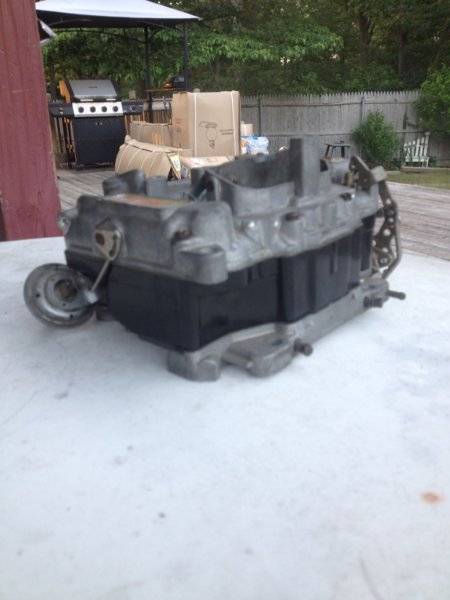

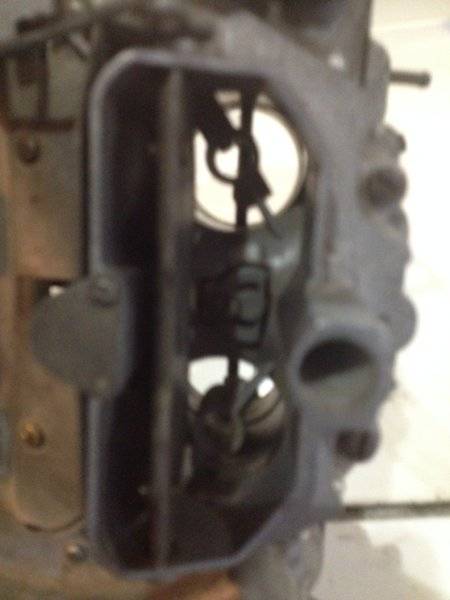

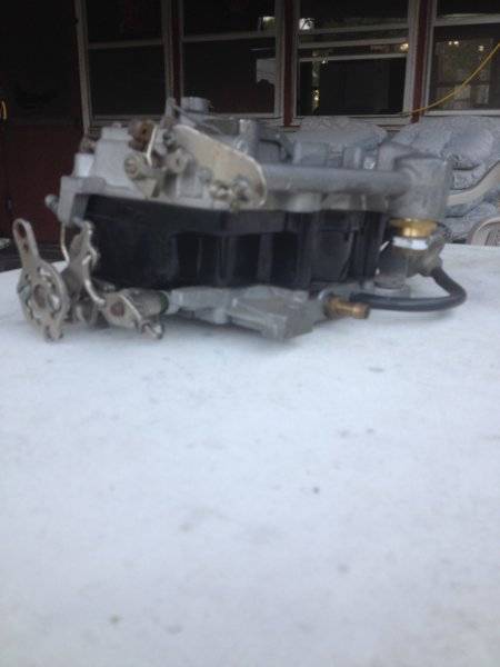

Just for show....
This is there small race unit @ an actual 850 cfm.
Carter also made an actual 1,000 cfm unit as well.
Manual choke, single ring booster, adjustable position throttle linkage attachment arm, a huge lack of vacuum ports.
