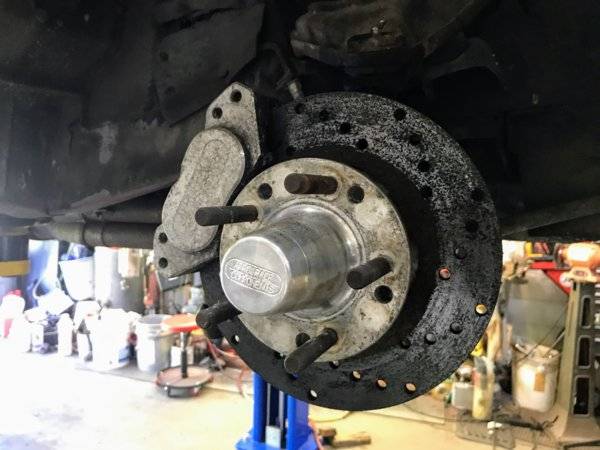

I know these brakes are made for drag racing, but does anyone know if I could get the rotors turned, replace the pads, rebuild the calipers and use them for the street?

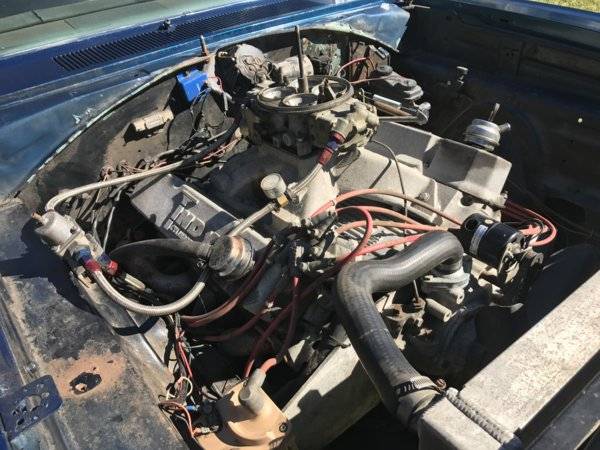

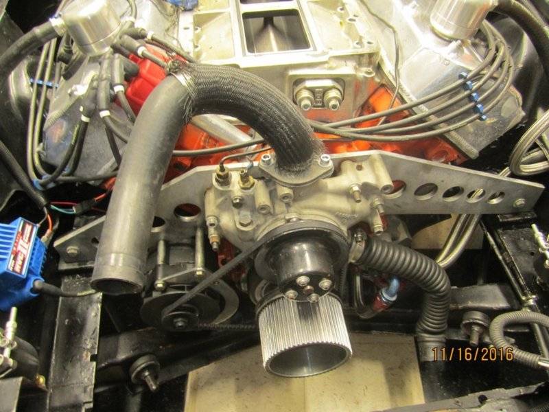

I need to get a mechanical fan, shroud, alternator setup and re-furbish the brake system. I am not sure if I can use the Dominator Carb for the street...I'll keep it on there for now since it runs so well!
Looks pretty bad. I gotta believe you could buy a new kit, for what the individual components would cost. I also wouldn't think about cutting thin/drag rotors.
then you could just put them brake , bendex calipers and thick rotors . not shear if ssbc or rammans stuff would work . do both cars have the same setups ? i have a couple setups from early e body and they fit b body as well . whats your plan , hows setup is that you've got ?

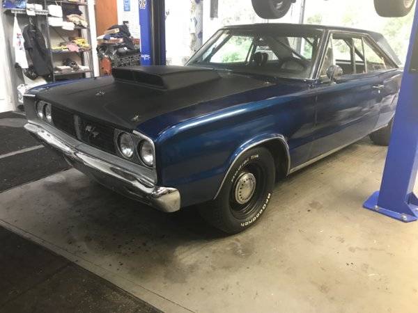

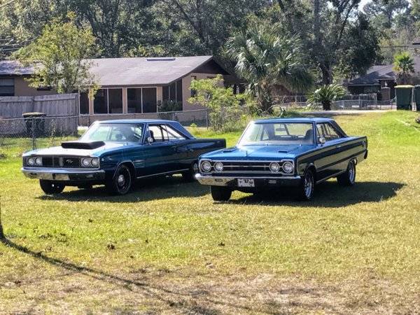

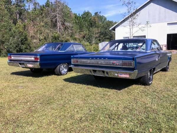

I got them both out in the Florida sun today! I changed all the fluids, cleaned out the fuel systems and drove them around a bit. Next step is definitely get all the brakes done!

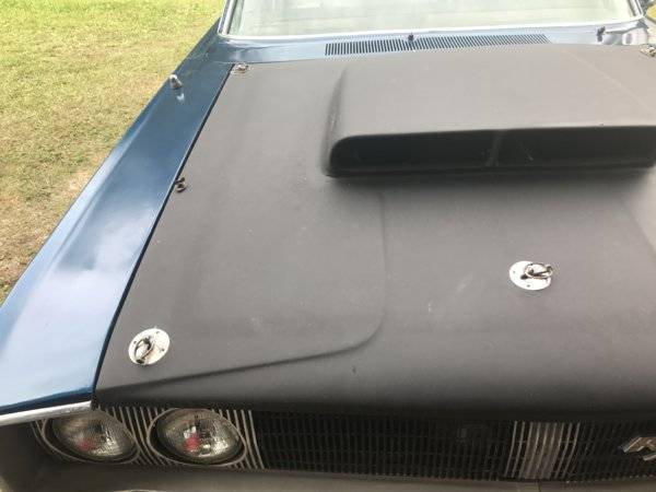

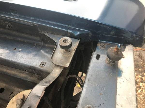

I see that the hood on the one car is a pin-on hood. Could you shoot some close up pictures of the attaching hood-pins or 1/4 turn fasteners...what they are and where the are located. Thanks, Mike

Here are some pictures of the hood and pins, hope they help. Looks like pins all around and two 1/4 turn fasteners on each side.

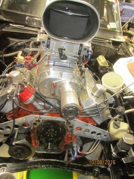

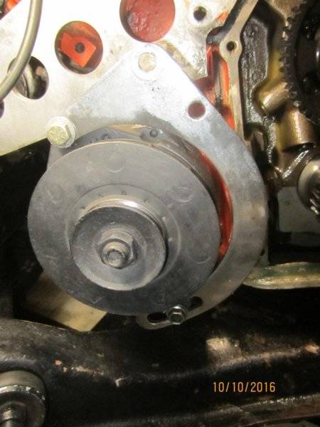

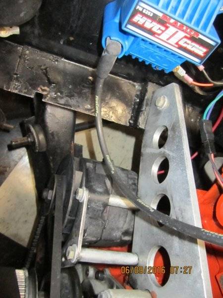

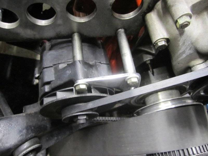

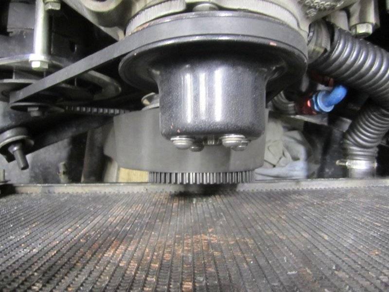

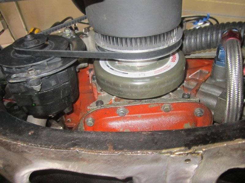

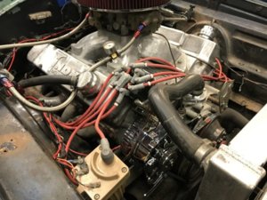

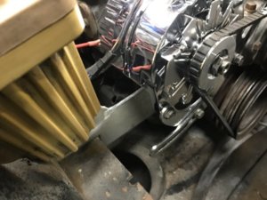

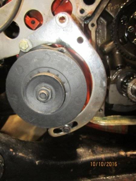

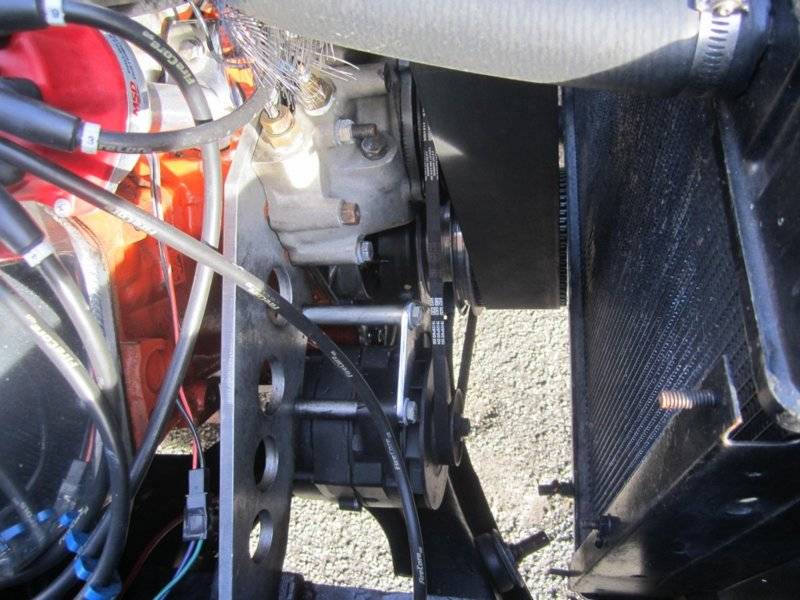

I trimmed the engine plate to make room for an alternator. I had a Chevy 1-wire alternator in the shop so I installed it and wired it up. Works GREAT!
