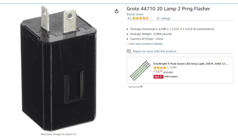

I used this LED flasher on my 71 Road runner.
I used them in both the turn signal circuit and the 4 way circuit.
