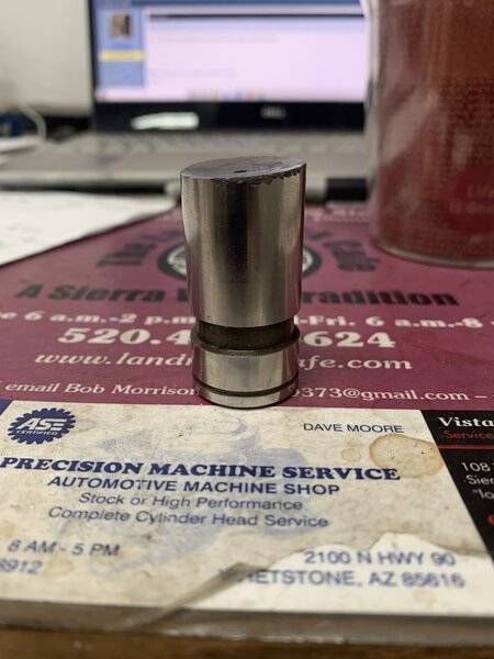

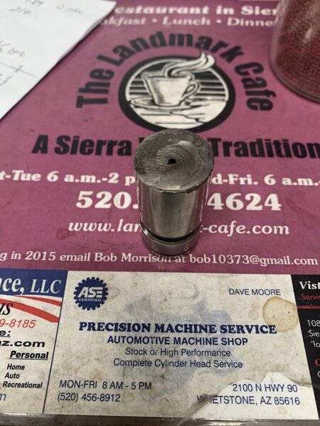

Not a problem, you wouldn't be the first not to be up on current oil technology, and cam requirements & oil technology and formulations have changed over the last 26 years. I do this for a livin', and am only imparting current requirements on you...
