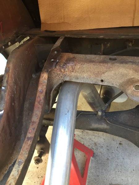

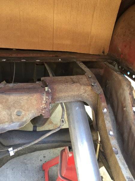

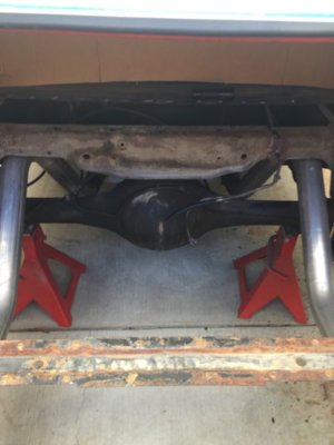

Hmm, I found this on my uncles 70’ RR, had air shocks on it for quite some time, cracked the shock mount and was welded back together by a blind guy. They get fatigued and crack because they weren’t designed for air shocks.

Wow, that's some scary stuff right there.
There's been several articles over the years published in the various magazines about the dangers of using air shocks on our Mopars
and that's a prime example of why it isn't a good idea.
As you correctly stated, the cross piece was never designed to bear the weight of the vehicle, as that isn't the purpose of shocks to
begin with. Springs bear weight; shocks control movement.
