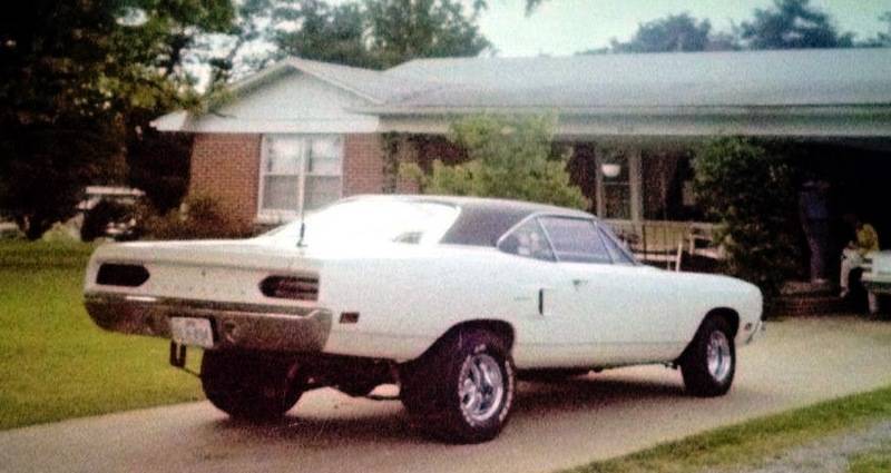

So am looking to raise rear end of 69 RR, Looking for that old school jacked up look...is my only choice air shocks?
Good LordIs this the look you're going for?
Sorta kinda, maybe not as high, but close! Am also installing 18" wheels, what size rear tires are those? Any body/spring mods u did to fit the tires?Is this the look you're going for?
So these 295/45/18's fit without any mods?You may want to re-think the 18" wheel idea. The largest diameter tire you're going to find is going to be around 29.5", which is going to be a 325/45r18. That defeats the entire purpose of the old-school street racer stance. You want some 33" x 15" rear tires at a minimum tucked underneath to get away with that look. JMHO. Honestly, just drive what you love and build it the way you want it. Life is too short to do otherwise. BTW I'm running 18 x 10's. 295/45r18 (28.5" x 11.6" tire).
sounds good.....yikes, you must have power steering!Yes, as long as you order the correct wheel backspacing and offset. The rear quarter panel is flush with the top of the wheel. Everything is in the stock location, the car isn't stock, but as far as the frame / wheel wells / leaf locations, yes, nothing has changed. I run a 27" x 10" tire on the front (255/45r18).

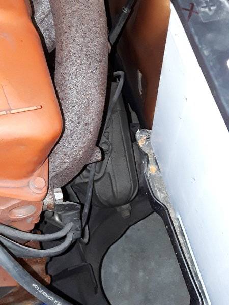

Any trick to adjusting those? Never done this beforeTorsion bar. Get the front set where you want, then order springs. Also when you adjust the tb’s, it will affect the opposite side rear.
Found it!No!!
Jack the car up, the lower control arms have a bolt under/in between them. You can’t miss it.
