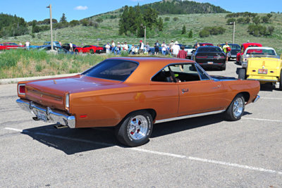

To give you a visual, a proper one. I had my springs re-arched +2" and I installed longer shocks. If I remember right they were from a truck or something like that, I can't remember. I've got 15" wheels all the way around but my rear tires are bigger in the back i think they are 275/60-15 or something close to that.
That looks great, but looking to be a bit higher in rear
