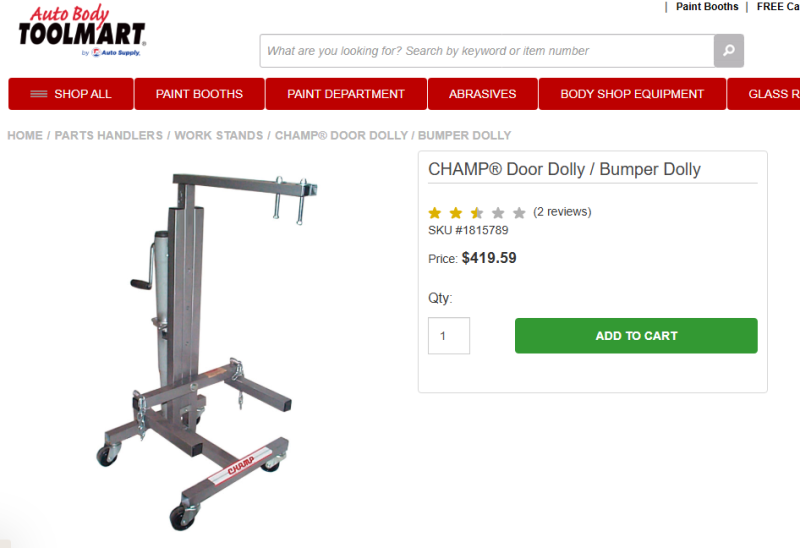

Lookie what $5000 buys you....

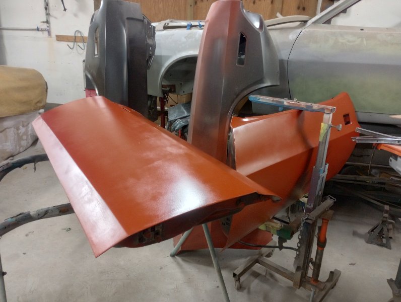

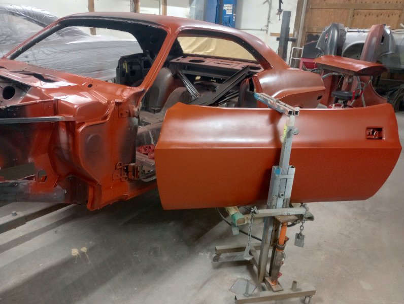

I have a "door dolly" ....... makes my life easy..... I've installed many freshly painted doors all by myself.....I use the crap out of it, it's like having a boy :D
I'll bet I can make something like that.

Get some casters, some 2 x 2 x .090 wall box tubing, a few rubber strips and some bolts...I could do this for under $100.
Heck....I could probably convert one of my spare engine stands.
I've mounted painted doors using dowels in the doors to just hang the door. This would change things.

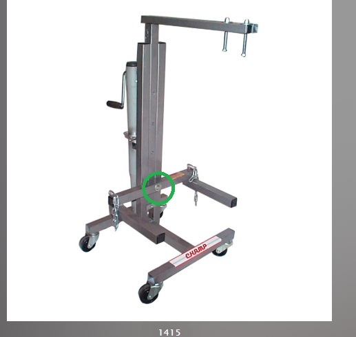

it pivots at this bolt, and the chains are stupid

Those pictures help. I do think I'll be able to make one of those door carts.
Although we had one specific vehicle at the plant, several different vehicles over the years, I made them all the time. The door buck had a groove in the bottom to hold the bottom lip and was carpeted. It was more or less, a plywood box with casters. The end of the door buck, had a pocket to hold the door perfectly straight up and down. The height was set for the car to have wheels and be on a flat floor. Once the door hinges were set, you pulled the buck out from the end. It was carpeted, because I built them to replace in system damaged, fully dressed doors.
