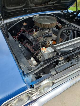

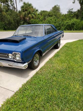

Haven't seen in person. But it's close to me. Built up 440/727 column shift. Steep geared 8 3/4 sure grip rear. Mini tubed with fuel cell.
The components I'm confident in looking. It's the Belvedere II part? I'm sure it was originally a 6 cyl hotrodded up. But if anyone has info to share about difference between Belvedere I and Belvedere II? Please feel free to share?

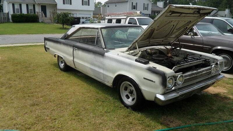

This is a Belvedere 1 You have a Belvedere 2. The hardtop is the difference as Jerry stated. Your car has the Silver Special interior too. Kinda neat. Same thing my 67 had.. Well sort of had the interior was almost completely torn up. lol
This was my 67.

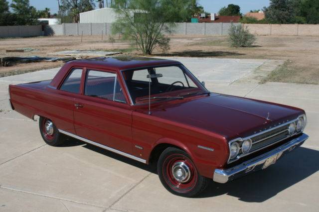

No the picture I posted of the maroon car is a 2 door post belvedere 1.
The white car was mine and its a 2 door hard top. There is no post on a hard top. The quarter glass and the door glass meet with a stainless strip seal.

The post cars were more along the budget line of cars. But I think they only offered it as a Belvedere.
Just like this is a 2 door post Roadrunner. They also had the Roadrunner in a 2 door hard top same as the yellow GTX below but with less options than the GTX.

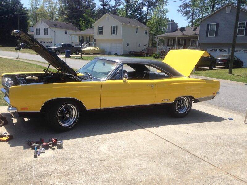

And this is a 2 door hard top GTX

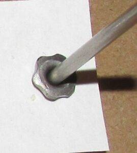

Vin number is located in the drove side door area next to the dash. Look at the rivets that are holding it on and make sure they look legit. They should have a flower look to them.
Like this. Some people will remove vin tags and slap them on from another car. Just be careful.
