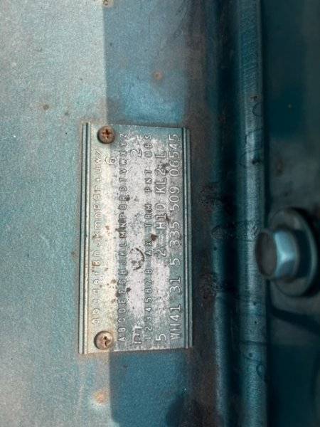

Hello Everyone,
The car checked out very well. Some issues but nothing too serious for a classic driver quality "survivor" which is what I was looking for. I have another question though:
I've always had trouble decoding pre 69 fender tags and this one is no exception. I've tried a couple different tools, this is what I got from realdash.net:
CAR: Dodge Coronet 440 4 Door Sedan
ENGINE: Unknown Engine code.
TRANSMISSION: 3-Speed Manual Column Shift HD
TIRES: Unknown tire code
MODEL YEAR: 1967
BUILD DATE: Unknown build date
AXLE: Unknown Axle Code
INTERIOR:
PAINT:
OTHER:
MOLDINGS:
15: Unknown Option
ABC OPTIONS:
X35: Unknown Option
abc OPTIONS:
w6: Build to Spec's for Canada
I know the interior is Turquoise and the paint is two tone medium turquoise roof over dark turquoise body, I was surprised the decoder didn't pick that up, but the other "Unknowns' have me baffled. I think I know the Scheduled Production Date and I know from the VIN that it's a 273.
I'm curious about the Axle AX-2; the 123-1 5, and the ABC-X 5
Thank you in advance for any help.
2 tone paint- K and L.
K is IIRC the turquoise. Not sure what L is.
Thanks, It's crazy that it didn't pick up the paint or interior.
This is a Triple Turquoise car.
K - Medium Turquoise roof, L - Dark Turquoise body and H1Q - Turquoise interior.

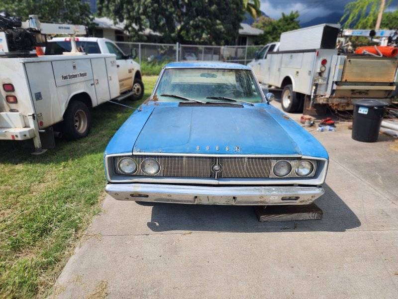

I thought: "All the Coronet guys are looking at that grille and going: ooooo, pretty "
Decent grill surrounds and hood lip molding could be worth as much as the whole rest of the car.
Some folks probably happy to pay shipping from HI.
Surrounds look pretty good from here.
