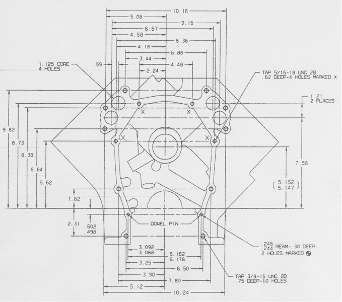

Turbosquid has some free CAD files & buy-able CAD files, not sure they'll be accurate dimension-wise. I disagree with andyf's opinion on this. My own CAD files are pretty sparse compared to what you're needing. If I remember right, the install instructions included with a Mopar Megablock has a detail drawing of the front of a block.
Turbosquid has some free CAD files & buy-able CAD files, not sure they'll be accurate dimension-wise. I disagree with andyf's opinion on this. My own CAD files are pretty sparse compared to what you're needing. If I remember right, the install instructions included with a Mopar Megablock has a detail drawing of the front of a block.View attachment 843358
Thank you so much for this. This is a great start. I will take a look at turbosquid to.
