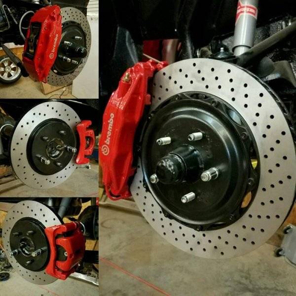

After reading some of your guys posts I’m not sure I have the correct master bore. Mine is a 7/8 bore recommended by bill Reilly of Reilly MotorSports. 4 wheel disc brake. 12.88” rotors in the front 6 piston caliper, 12.19” 4 piston in the back, no power.

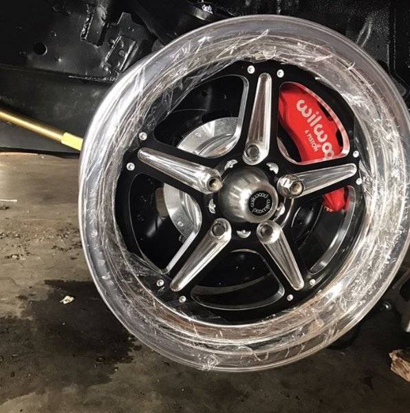

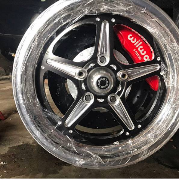

For reference to the post here’s a 12.19” rotor and 4 piston caliper on a 15x7 with 4.5” backspacing. As said before it will vary wheel by wheel and you need to know the caliper clearance of the wheel!

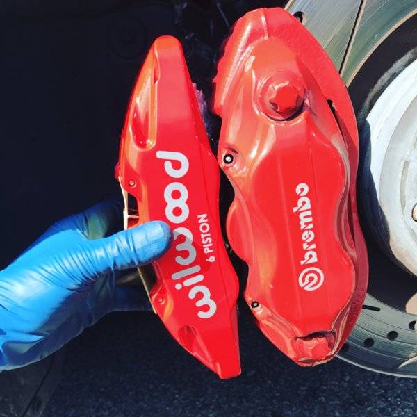

Here’s a comparison of my brembo 4 piston calipers to Wilwood 6 piston. Brembo pots are much larger.
