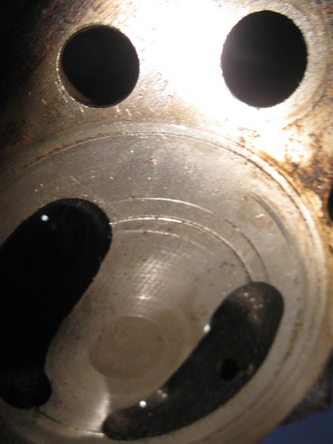

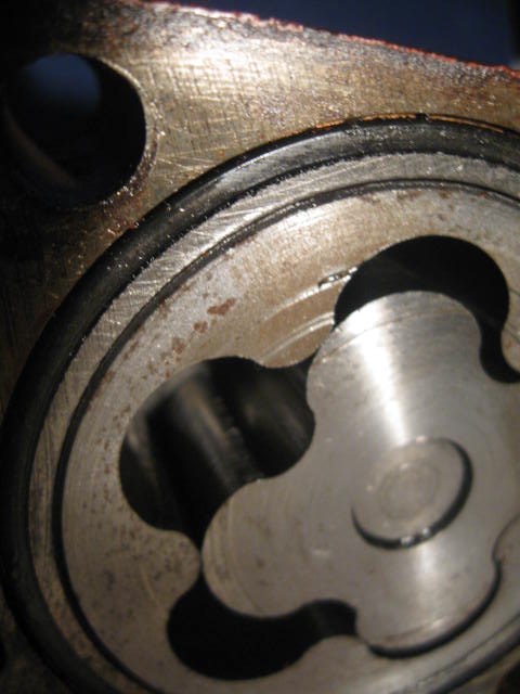

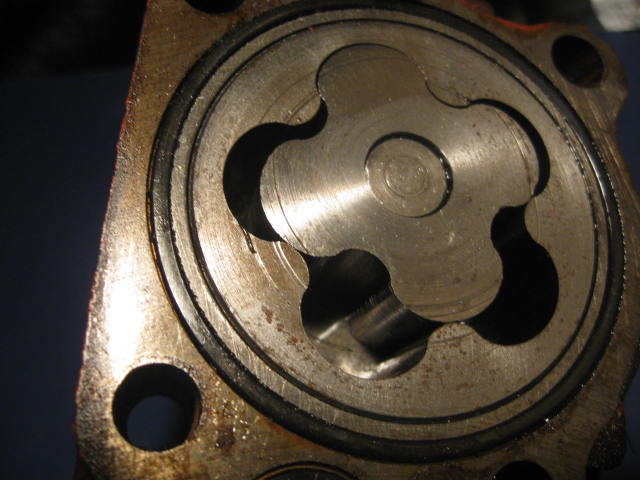

Need to get back to basic diagnostics.Reinstall pan & pump,remove distributor and drive gear.With oil in pan,use a drill to spin the pump {counterclockwise}.You can hear the pump start to labor once it's primed and starts moving oil.It may take a while.If you still have no o/p,the next step is to remove the valve covers and verify that all the lifters are still in place and that no rockers have excessive play and maybe do a valve lash check.You said the pump cover has some scratches.Are they just small scratches or are they GAUGED??If the pump is still out,can you post some pic's so we can see the "scratches"??
lost oil pressure
Here are some picsnof pump, and I will try your suggestions. thanks, ken

Ken,do you still have the oil pan off??Something went through the pump,hopefully it was caught in the filter.Do you have a torque wrench??I suggest you remove one of the rear main caps and 2 rod caps in the rear of the crank for inspection.Make sure to mark the caps position with a number and arrow pointing foward if they are not numbered already.I also prefer to reinstall the nuts back in the same location also.This stuff doesn't just fall off after undoing the fasteners.For the main cap,loosen the 2 bolts all the way,lift the 2 bolts up about 1/2 inch and use them to move the cap back & fourth to remove.The rod caps you can tap with a leather or rubber mallet.

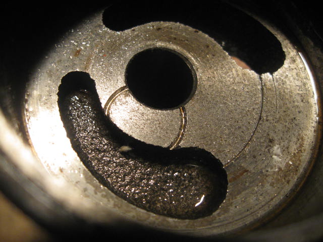

another shot of the bottom of pump, is this normal?

Sure,take a look at the pick up screen and cut the filter open to check for debris.When you pop the caps,that will tell if there is any real damage.The marks on the pump show thst something passed through.Those pumps are not alot of money and depending what your finding are will determine the course of action required,if any.:glasses6:
These pumps will move oil with 10 times the amount of gouges than what you show here. Sure, some dirt got in there but I doubt this is the reason you have no oil pressure.
