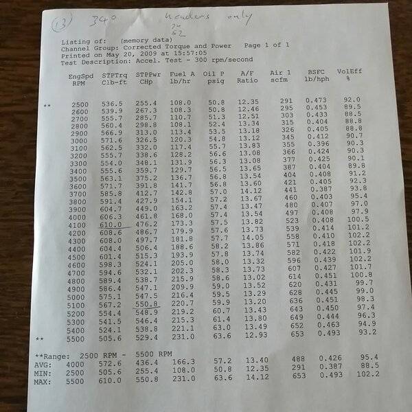

My 500 stroker was around 9.25:1 with ported 452 heads. The cam was a hydraulic roller 236/242. It made 550 HP and 610 TQ on the engine dyno. I later changed to 84 cc Eddie heads, and picked up a couple of tenths. Never had it back on the dyno but I figured it was at least 575 HP. My opinion, just run it.

I could live with that, any work on your heads? Do you have your dyno sheet? what did you torque curve look like if you don't mind sharing?!?!?
Thanks
The 452's were home ported and flowed about 250 CFM. The Eddie's were port matched and opened up a bit in the pushrod pinch. I just cleaned up any sharp edges in the bowls, but never flowed them. I will see if I can get a picture of the dyno sheet

Not sure how easy this is to read, but over 500 ft/lb of torque from 2500 to 5500 rpm.
