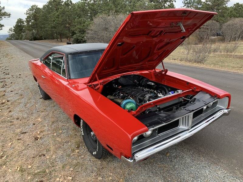

      Top fuel cars ARE boring. Purely because they’re basically all the same, there’s no uniqueness to them. Same goes for big block powered mopars. IMO once you’ve seen one, you’ve seen them all. That’s why I like my car so much, it’s something unique that no one else will ever have

          When was the last time you saw an LS in a 69 charger though? Bet this is the first one. The car it’s in is the reason it’s unique. But since you’ve brought it up, “lack of knowledge” isn’t any reason for not building a BBM, cost is. Why would I choose to spend $5k+ to make 800hp when I could spend 1500 and do the same thing?

              Never tried to get anyone to accept it lol. Just sharing my project

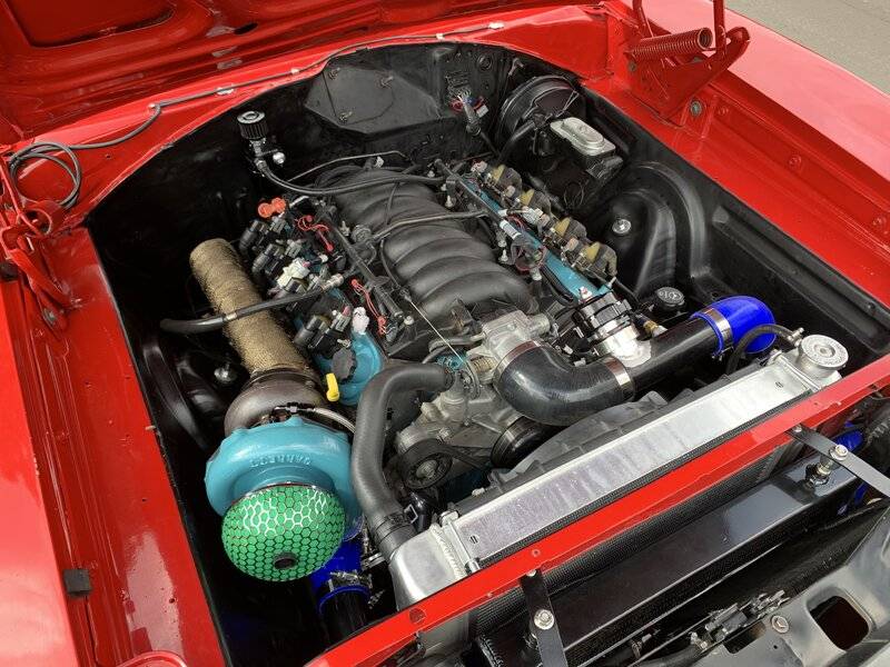

                                Took the charger out for the first time with the turbo. Unfortunately it blew the oil cap off and sprayed oil EVERYWHERE lol. Other than that it ran pretty good, still needs lots of tuning though IMG_6542.jpg IMG_6541.jpg

                                  You need some breathers in the valve covers on that thing and a catch can.

                                    I've got a catch can but I had the lines wrong so it was boosting the crankcase. Just changed it up so we'll see if it happens again

                                      What are you using for engine management? Aftermarket eFI?

                                      Holley Terminator X. It was only few hundred bucks more than a standalone harness and factory computer and is wayyy more tunable and user friendly

                                        Yeah I’m using Holley Dominator. Love it, although it’s way smarter than I am, lol.
