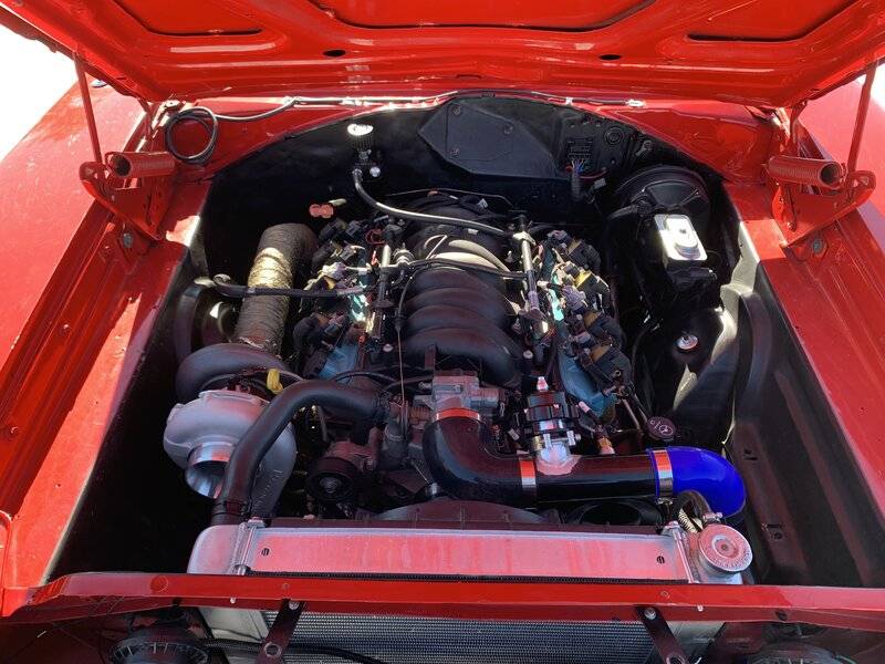

Havent done too much lately, I’ve been busy moving houses. Just put a new VS racing 78/75 on and did some tuning. This thing really moves now lol. And I took it out today to play in the snow

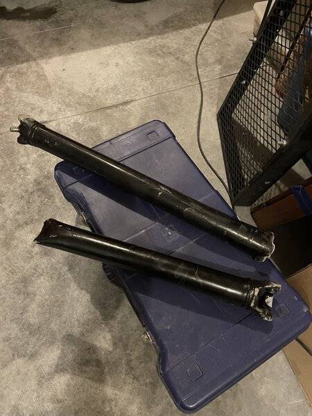

Broke the driveshaft a couple days ago and put a massive dent in the floor. Oh well, I guess it just gives me an excuse to tear the car down and start doing racecar stuff lol

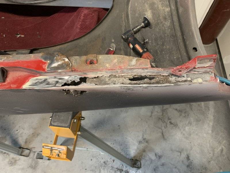

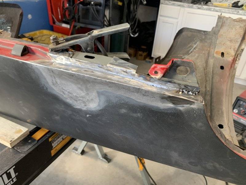

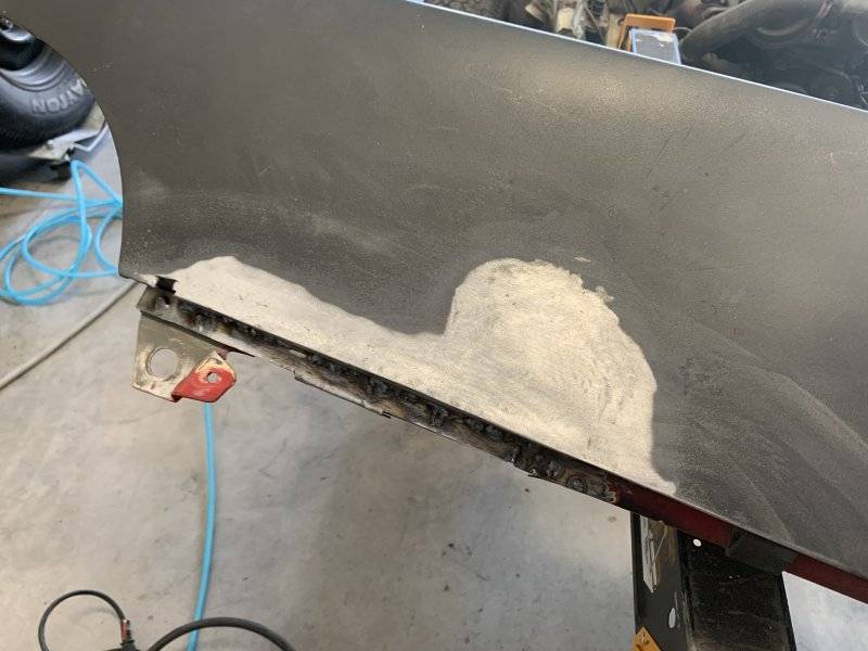

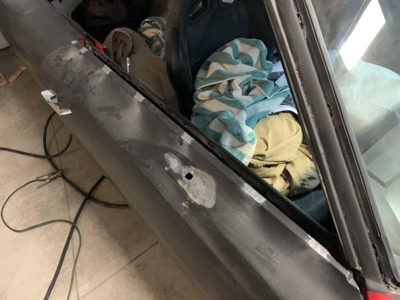

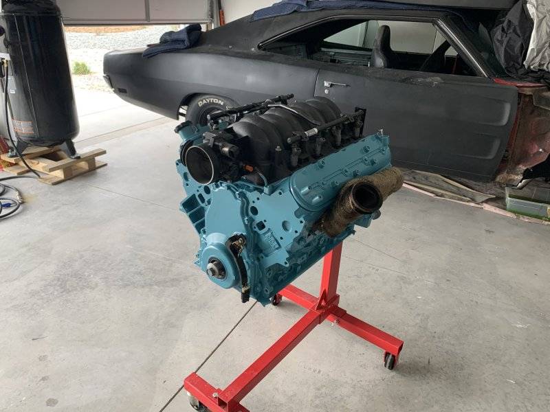

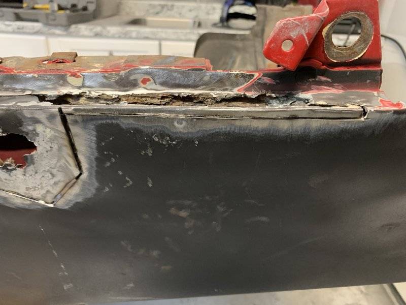

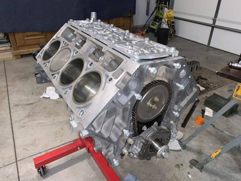

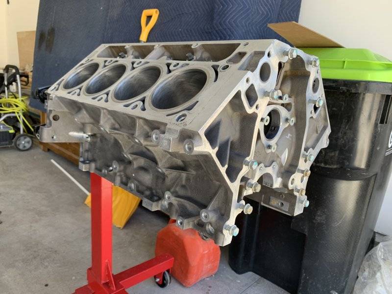

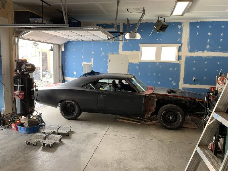

First update in over a year and a half! The charger turned into a shelf for quite a while unfortunately, after I melted some holes in a couple pistons lol. I finally got back on it around a month ago and built a new gen 4 aluminum block 5.3 for it. Just a pretty basic engine with flat top pistons, BTR cam, 706 heads, ls7 lifters, ARP head bolts, etc. It's around 10.3:1 compression which is higher than I would like for a turbo motor, but I'm thinking it'll be fine on E85. It'll take 100 pounds off the nose and hopefully make in the neighborhood of 850whp. While waiting on parts I started stripping all the paint off the car and putting it in some epoxy primer and I unfortunately found some rust in the top of one of the fenders. So I got that all cut out and have it almost fixed now. I also started welding up some of the unnecessary holes in the doors and quarter panels. Trim has always made the car feel "cheap" to me, so I plan on getting rid of ALL stainless/chrome trim on the car. That's all I've got for now!
