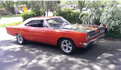

thank you all, this is very helpful...i've been scanning the forum for tire/wheel combos and came across the attached car (posted by Hyrdoon)...these wheels sit really nicely....i believe these are 17 inch rims, so that would change the tire width/profile etc. anyway.....lots to think about...i'll try some sites that allow you to superimpose wheels on an image of your car to help. TorqThrusts always look good.
best, Paul.

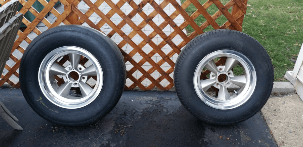

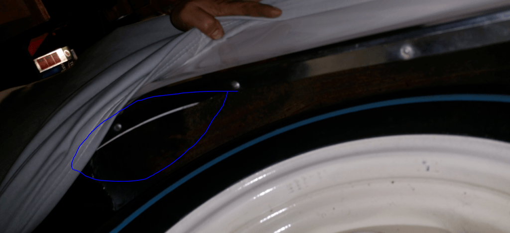

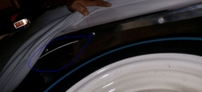

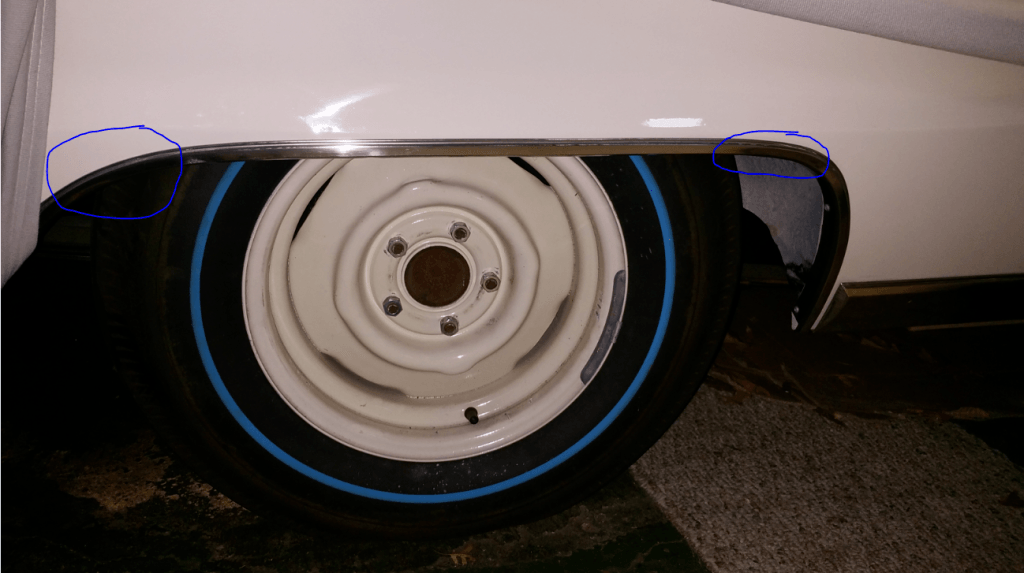

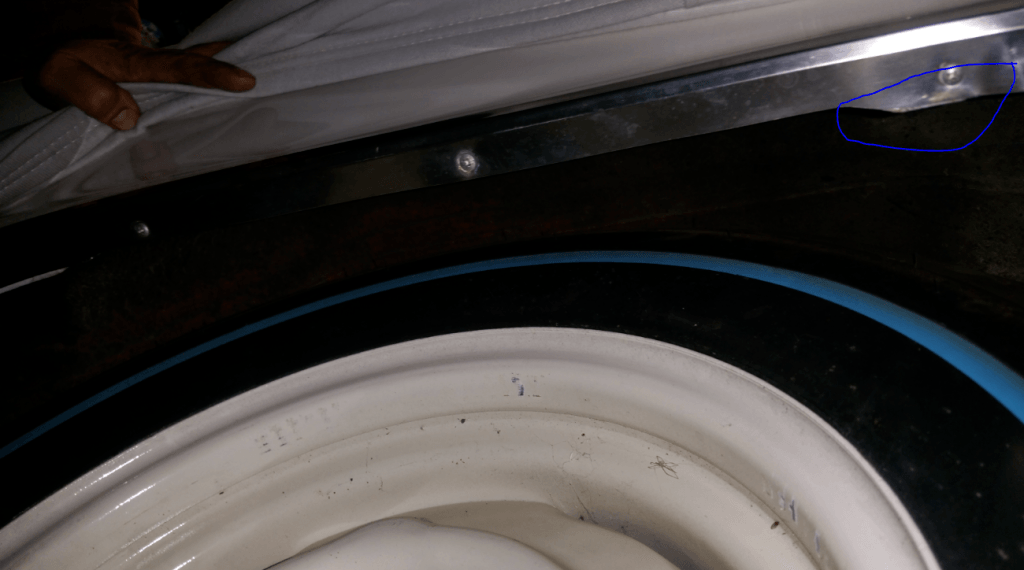

ok guys, it's been a while, but the wheels and tires are ready-see attached. Now i put them on and they fit. Back tires fit, but there are a couple of spots on the wheel well which i have circled in blue that protrude. At some point i can see that they will probably scrape the tires. Should i get these rolled back or grind it down. seems like the roll back would be the cleanest option.
best, Paul.

On my 67 coronet I have vintage 15x7 with 3 3/8" backspace torq thrust wheels. Tires are 215/70-15. With people in the back seat the sidewall will barely rub the inner bulge that's up in the fender well on 66-67s on turns.
I had the same problem with L60s on the rear of my 68 GTX. I raised the rear 1-2" by getting couple of "add a leaf" to my springs in the back. Bought them from Summit Racing. Cheap fix at about 40$. Easy to install too. Now no rubbing.
