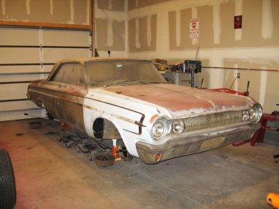

I've owned this car for a little over 10 years and I'm the second owner. Its driveable and an original numbers matching 383 4speed car. Here's a pic when I was doing the brakes, converting the rear drums to slip on and cleaning the fuel system a couple years ago. I have every piece of trim and almost every part I need to do a complete restoration, just trying to decide which direction to take.

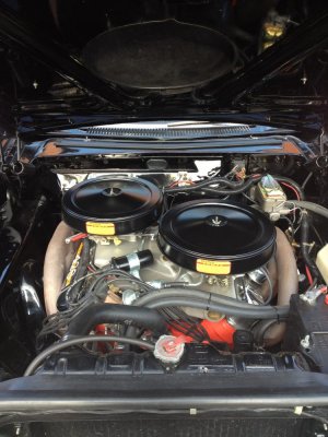

I have the A&A cross ram setup on mine and it drives fine. I drive about 2K miles per year on mine wothout any trouble. View attachment 215571
I'm right there with Pahighlander--A&A set up including their kickdown linkage along with 2-600 CFM Eddy's--runs absolutely GREAT and love the "Wow Factor" when the hood is raised!!!

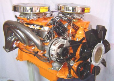

Max Wedge Engine completed  4.jpgI had an original 426 cross ram 4 speed with 11 to 1 pistons. It had a Mopar 509 cam, but I reduced the carbs from 750 to 625 cfm. I set the initial timing at 18 degrees with 36 total advance ( no vac adv). It had a manual choke on each carb, and ran fine around town after it warmed up.
