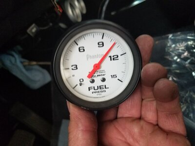

So I have been having some issues with a new motor and decided to hook up a fuel pressure gauge to rule out a low pressure condition. Check this out, brand new Carter 6903 at idle.
Does anybody make a good reliable mechanical pump that puts out 7.5 psi or so and will support a 600 hp motor? Kind of leary buying another one of these Carters.
I've read your other thread on your detonation problems and you might be beyond this point now but when you're having that high of a reading it could be air in the line. I experienced this with the latest pump that I just installed. It was showing 10 psi at first but after it warmed up it came down a little. Then after a 15 min drive it was down to the 5 1/2 psi. Some cold start ups after sitting overnight or for a day or two I'll still experience the same thing. I never had this with the pump before the new lighter spring and diaphragm.
It would stay at 10.5 - 11 at idle. Cruise was 9 - 9.5. And wot it would slowly drop to 6 until I let off. By that time I was going to fast for not being on a track.
