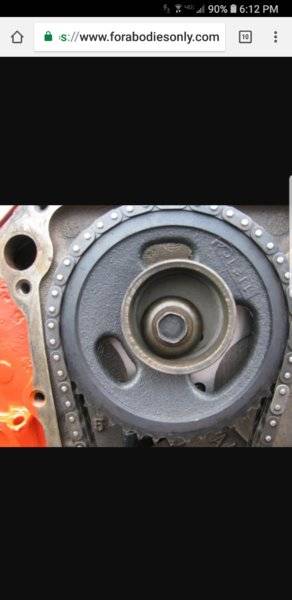

From FABO linked thread
"Cupped washer towards rear and thrust plate needs to be on. The cupped washer pulls the cam forward against the thrust plate then just line the keyways up and you're good to go."
See pic of correct installation for cupped washer:
So there is the answer to the builder's claim that
And could this be the solution in your case?

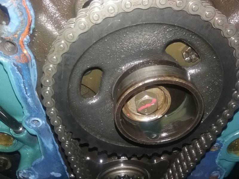

They put the washer on upside down!! I'm amazed it ran as long as it did.
Wow! Thats why I assemble my own engines. Check it for groves and wallowed out opening where the keyway is. If it looks good flip the washer and you should be good to go.
