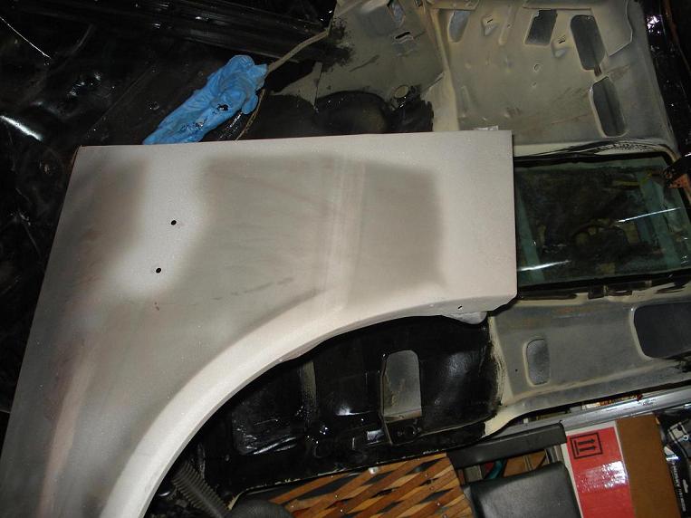

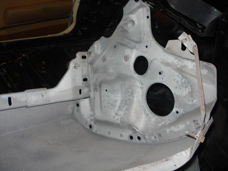

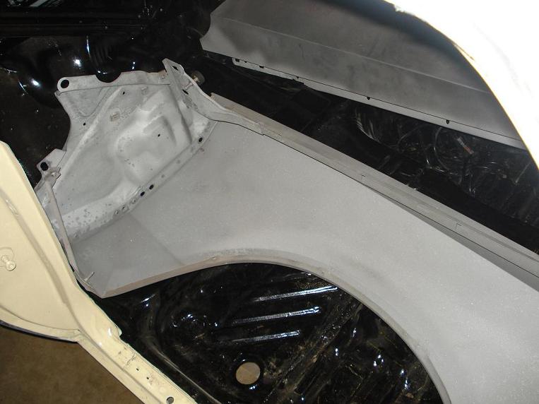

Had my fenders media blasted inside and out. The inside and around the edges the surface is rough and the outside is much smoother like they used different media on the rough stuff, is this normal? If I would have noticed when I picked them up I would have asked. You can see the difference in the pics. I'm going to have some stuff done at another media blaster, I'm trying to see who does good work before I have my good car done. I've heard horror stories of warped panels and other damage.
You are correct, they did use different media. With me, I like to make everything uniform in appearance so the questions don't come up. Also, these fenders and cars we deal with (upwards of 80% of all my cars I do are MOPARS) are hitting 4 decades! Their will be rust. The rust has to come off.
These are well done fenders. Yes, panels can warp, I know, I admit it, I've warped the crap out of them before...can't hide from that, but, they were aluminum, and filled with Bondo, not warping those baby's was an impossibility. Now, if I get the same stuff in, I charge double, because I chemically remove the Bondo before blasting, use much finer Acrylic plastic media.
Warping steel fenders/doors/panels can be done, if you are a real bone head; very high; too high air pressure, and a media like sand will and can mess up things.
Again, good looking fenders! I say he did a good job on them.
