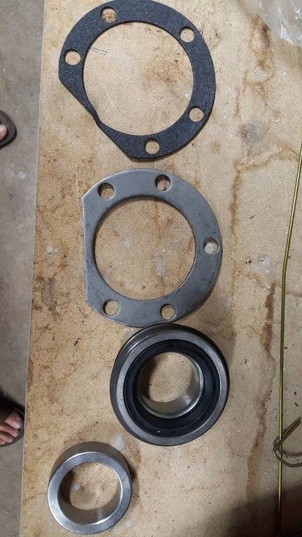

So I have a set of the green bearings with my Wilwood Kit that I got from Magnum Force. The retainer lines up to my axle fine but the bearings went in sloppy with like an 1/8" all around. Any ideas or did they just send me the wrong flippin' bearings?
Is the o ring on the outer race of the bearing?
How old is the housing? Could be the ends are out of wack!
Is that a 8-3/4" or Dana 60? When I went to get a axle seal for my original Dana 60, I kept getting seals they say they fit 8-3/4" and Dana 60?, but the Dana 60 does take a different seal with a larger outer diameter.
It's for an 8 3/4. The bearing cups are some that were at the shop and measured against my old rear end so they shouldn't be out of wack. I'll need to look and see if there are any identifying numbers on the bearing to match up to 8 3/4
It's a sheet metal rear end and new axles
