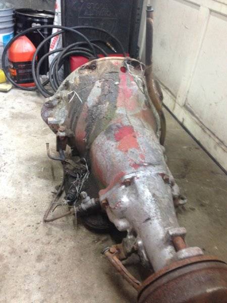

Is there any difference between a motor home 727 and a car 727. Does it have more heavy duty guts or better cooling or is it just a 727 in a motor home.
most if not all motor homes have a short tailshaft 727 with a brake on the end of it. you could use it but you would be piecing all sorts of other crap together
I can change that to a regular type tail shaft. I was hoping it would be heavy duty to some degree.
Yes they are more heavy duty. Extra clutch plates and 4 gear planetarys. Most have short tailshafts with a bolt on yolk Similar to early power wagons with the divorced transfer case.

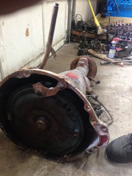

Ok got to get rid of the drum brake on the back so what tail shaft housing do i get.

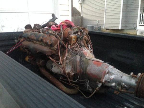

How did my trans get to your house
lol Its just a motor home transmission. I'm doing a low compression 440 build it was bolted to the 440

Mine had a 440 bolted to the front also going to turn mine into a 512 and want to use the trans
What are you doing with the tail shaft issue.

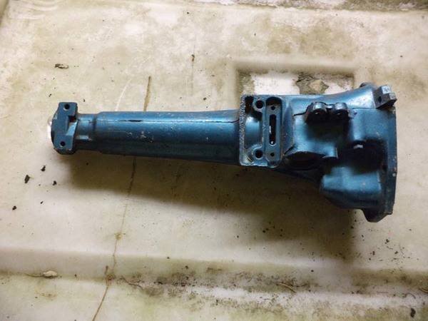

The entire transmission has to come apart to change the tail shaft. At that time you could use a tail shaft and housing from a regular 727.

It doesnt look hard at all to rebuild. Just need one special tool to get the clutch packs replaced. You will see that tool in this series. You will need a tailshaft like this one also the output shaft that goes with it. Since they are different lengths
